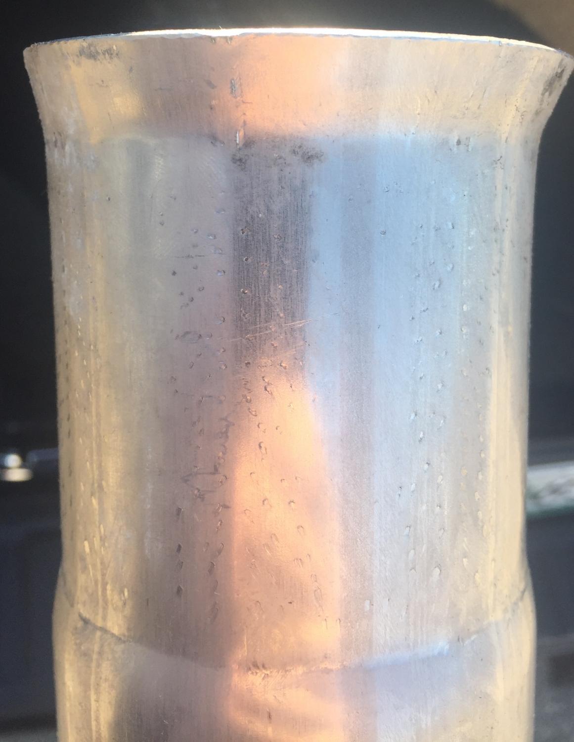

The Gibson pipe is the reason it's leaking. They attempted to make it like the stock flex pipe and failed miserably. I'm taking it Wednesday and having my stock flex pipe portion welded onto the Gibson pipe so it will seat up properly. See the pic. It's not even close to the stock one. One side is flared further then the other lol. It's Sad really.

I already did. The one in the pic above is the replacement.
