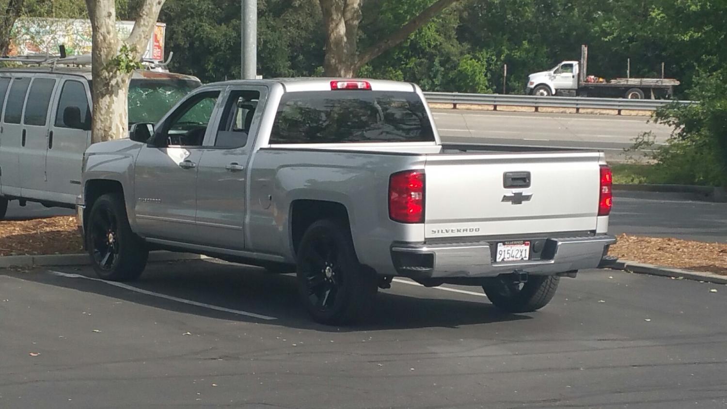

Had a belltech 6401 shackle drop installed yesterday.....unknown to me until I got home and crawled underneath.. (had my work clothes on)....they also removed the blocks....to the measurement she's even....However I wanted a little bit of rake....going in Monday to have the blocks put back in....I asked for a 2 inch shackle drop....guy said his installer said without the blocks it would have only dropped an inch.....according to belltech its a 2 or 3 inch drop....The 3 inch being the block removal......on a side note...zero vibration....rides great...thought I'd post a quick pic.

For now the stock shocks.....I will end up replacing them but with just the shackle drop I wasn't immediately concerned with their replacement....With the 3...they are definitely compressed and the bums tops are closer than I would like....for me the 2 inch is more my personal preference.
I will post pics with the blocks put back in place Monday afternoon.

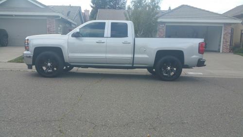

I would just move the spring attachment points to the lower holes on the shackles instead; a whole lot less work than putting the blocks back in which necessitates removing the U-bolts that are torque-to-yield. It will gain an inch while the putting the blocks back in yields 1.25"; the difference is miniscule in my book.
Personally, I like the way your truck looks as depicted in the photos. I wouldn't change it.

That's a good suggestion...appreciate it....in my ocd mind...perfectly level looks rear low to me...thanks for the idea tho...
I appreciate it guys...I put the blocks back in this morning...a small amount of rake without any illusion of being rear low....I don't know what it is...but every silverado I see that's perfect measurements from fender to ground look rear low to me....I'm happy with just the shackle...

Here is a pic with shackles only...block put back in....my personal preference....If I ever remove the block again...I'll get shorter shocks..or shock relocaters...and shorter bumpstops...
