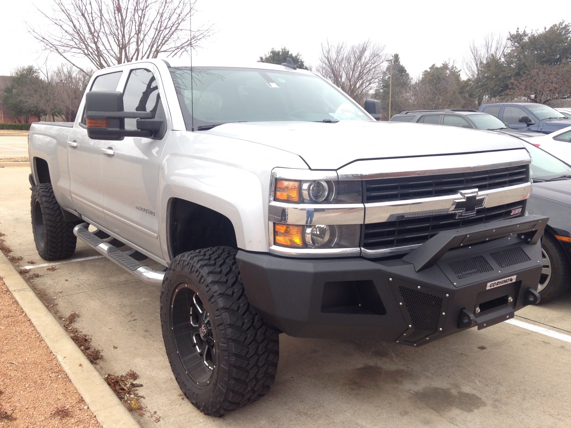

Lift leveling a 2016 2500hd, can I run 35's
Looks awesome! Did you do the fender mod yourself? What sizes exactly did you go with?
I did a level, the front and rear fenders are the same height from the ground .
  • Replies 80
I used the 295/60r20 Nitto MT 20 x 10 -24 and 3.5 rough country Level lift
I might go with a similar size. I really really wanted the 35x12.5 on a 0 or -18 wheel. The “shop” in town says it can’t be done without a 4-5” lift. So much so... they won’t sell me the wheels and tires. Told me to order online, he doesn’t want the liability.
use this sight to help
https://tiresize.com/comparison/
Interesting. I have that already. It’s the wheel offset that I think is a huge barrier. I’m not sure if you can maneuver a 12.5” tire in there unless it’s a 33... your tires look much wider than an 11” wide tire.
So I ended up with nitto terra grapplers 295/60-20 with 20x9+0 wheels.
Those look really good! You may want to edit your post from Terra Grapplers to Trail Grapplers though, haha.
Any rubbing or trimming?
Ha ha, you’re right. I went in for one thing and came out with another.
Yeah, I haven’t figured out why my truck is so mechanically messed up. I was supposed to get the +0 offset and 295 tires which shouldn’t have required more than some minor trimming (from what I’m told. But now my keys are turn all the way up and I think I require some drop spacers and UCA’s. (I have a picture thread of my cv angles). So I love what it looks like, I’m still working with the shop to make the truck right.
So does anyone know the biggest tire I can get without rubbing? Currently running 265 60r20. I don’t want new rims.
I previously had 275/65-20. No rubbing no issues. You might be able to go a little larger as long as you don’t got wider
