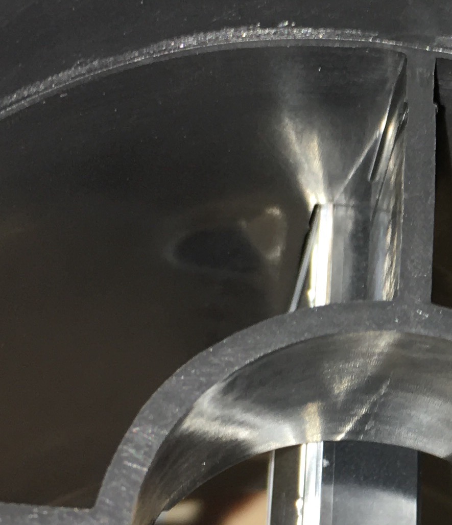

The MASS Air Flow which is behind the + or X plastic molded support piece that is inside the cylindrical section usually used to support the Mass Sensor and for structural integrity. The flashing spill over on the edges might not seem like a big deal but it will most certainly effect your transmission and shifting behavior! Due check this component as mine which is 2016 GMC had Excessive flashing on mine too. Talk about trying to find drivability issues your never going to find?

Is this referring to the bur on the actual X or + or the bur around the the outside? On mine the filter side of the x everything looks square and sharp. However there is a bur around the out side ring. Its a molded piece but on the inside it looks welded?

Exactly IT VERY GOOD SON! Yours looks EXCELLENT A MODEL OF PERFECTION.......I assume yours is newer 2017? Anyway that piece with the leftover slashing like mine had 1/8" maybe even 3/16" in corners created a huge problem for me and many others! Good work, nice picture....gentleman I too stroked myself when I read about and chuckled finally looked at mine around 20K and sure shit I had the problem child!
Everybody make sure yours looks exactly like this picture clean and sharp!
It's a 2016 GMC Sierra SLE 1500 Z71 with 20k on it. I guess that a good thing mine looks clean. The bad thing is I guess I still have a shifting problem. I unplugged the battery for over an hour. I did actually smooth all the casting burrs in front of the mass air flow sensor. Figured it might be causing turbulence in the air around the sensor? Frustrating problem! For the most part, I love the truck. Wish you could turn off all the electronics. Even if you turn off traction control and stabilitrack you can still feel the electronics and they it turns back on by itself over like 35mph...sounds like the 10 speed is coming soon. My buddy has a Rapture and the tranni is amazing!
