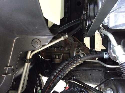

Does anyone have a pic of what it looks like?
