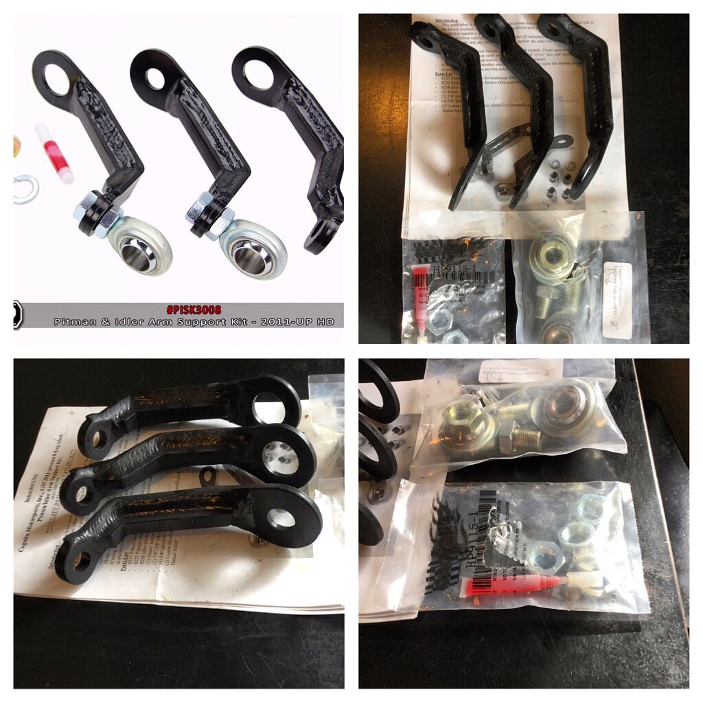

I'll order the PISK kit also

I think I'll install the cognito PISK kit when the idler arm is replaced

I am also going to install the Cognito PISK kit, along with their 4" lift package, assuming or course that GM can get there act together and get this fixed...I don't think it's even or their radar right now and was a monetary decision by GM bean counters to let it slide...sad.

The pitman and arm assembly is like 120 bucks, almost not even worth my time going there for warranty since I''ll be taking it apart anyways to put the pisk on

Did you order your pisk yet? I bought a kit but never used it if your interested. PISK-3008
