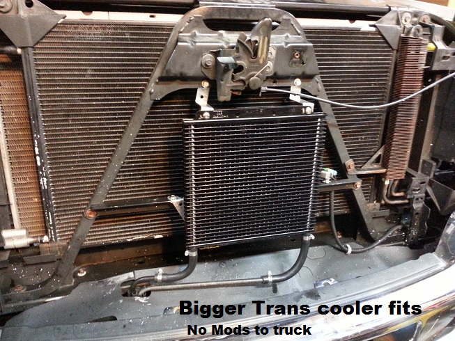

I would pull the grill off ( easy) and put in a bigger trans cooler if you are going to tow, and especially if you will plow.

The transmission is pretty solid...since you aren't towing much anymore, I wouldn't bother with the larger transmission cooler.
