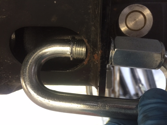

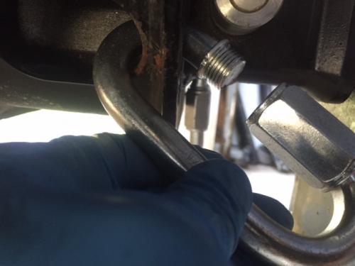

Debra , I had same problem and theres a couple ways to resolve it. Both answers you got are good , here a few pics of my fix. There rated for 10,000. They just barely fit through the factory holes. There 9/16 size.

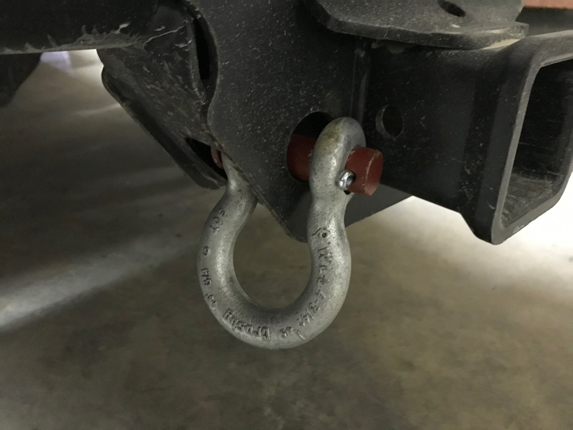

Or serious shackles.  I used Crosby shackles, each rated at 4.75 ton with 3/4" alloy pins.  Kinda hard to imagine carabiner style being rated at 10K lb each.
Yeah, I dont see any that are rated for 10k.  The 1/2 ones at home depot have a 9/16in opening and theyre rated for 3300 pounds.  Might not have enough there.
I made that same statement in another thread and got beat down...

I wasn’t trying to beat you down, Steve, it just didn’t seem logical.   The Crosby shackles I have are 3/4” steel alloy and rated at 4.75 tons each... 9.5 tons in combination.  Wanted at least that whenever towing to max trailer rating of the 2500.  One would think it would take similar dimensions of a carabiner to be roughly same strength.
I suppose in combination they might get to 10K lb.... 5K each.
No, that statement about questioning the safety of those quicklinks...I said the same thing in another thread and got multiple replies telling me how great they were.
I like your solution, that's likely stronger than the web of the receiver itself.
Steve
2012 2500hd 6.0l
In reality, while the trailer might weigh say 10k pounds, it doesn't really place 10k pounds on the receiver at any one time under normal conditions. But coming off the hitch, and jerking the chains can result in a significant shock loading of those links...those quicklinks may be rated for 5k, but I bet that's a static load rating, and not a shock load.
I just have had scarey results using quicklinks on other applications and, unlike most here, I had an 18k pound trailer break the pintle hitch off an HD truck (HD as in 35k pound GVW) at highway speeds. The jerking caused by it breaking the hitch, and dropping about six inches onto the chains, was almost uncontrollable, even with a truck that big...

Work load rating is static and not side loaded. The shock load will destroy the shackles fast, not to mention it will side loaded the shackles will never reach the static load rating before failing. But still better than nothing.
If we're talking shock load, then those little loops on our hitches won't hold chit either. Neither will most safety chains.
