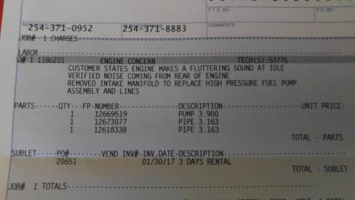

The dealer finally able to diagnose the problem with my truck.
Attached is what they found.

Excellent post! This is good that you got your noise figured out. Temperatures are warming here so it won't be long and I will be squealing like a PIG again! Although, I am the only one who hears this unfortunately....Thanks for sharing the info!

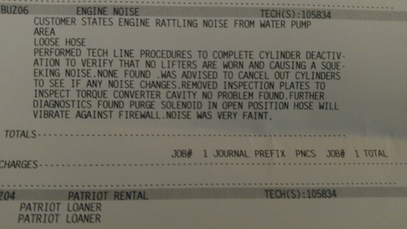

Was your issue the squeak when the engine goes from v4 to v8? Or the tapping like sound coming from the engine bay? Glad they got you fixed up.
