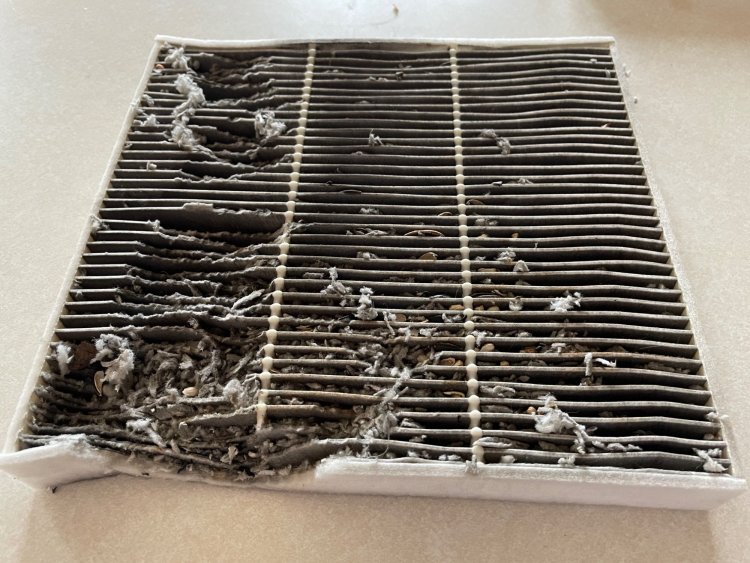

Slightly different spin on this topic...after the dealership replaced the cabin air filter I started noticing a whirring or tapping sound that goes away when you turn off the HVAC. Quickly found that it's the fan that sucks air down through the cabin air filter. I took the filter out and expected to see a leaf or something in there but can't see anything, doing my best with a mirror to see the whole way around. Anyone else run into this?
Yes. You have a piece of debris in the blower. I have large hands and my compressor didn't work, so I took the blower out and one tiny piece of leaf had fallen into the blower. I wish there was a relief cut above the filter so when it is removed it doesn't "Scrape" the leaves and other debris off and down into the blower housing. The black cover isn't fun to remove and one screw couldn't be reinstalled as the angle is jsut too sharp to get the screw back in with a driver on it, it resides in my glove box..... This last time I changed it, I again had a leaf fall into the blower, but lucky for me my air compressor got it out.
Crap design if you ask me.....
Any advice or pointers on how to get the blower out?
remove the black cover above pass side footwell, then just remove the blower with a few screws and a plug. simple

Wow.... bringing up this old topic, but I never found an answer to the original question. Where is the cabin air intake? I changed out the cabin filter and found stems, whole leaves, lots of debris. I don't understand how those get inside the intake. There certainly are no openings that large by the wipe cowling where they could simply fall in. The only area that seems to collect large leaves is in front on the radiator area, at the bottom part of the grill. Lots of branches and large leaves trapped there.

Haha. Searched for a way to add a screen and came across this post. Here's my mouse I pulled out of the cabin filter.  http://imgur.com/a/cC1HgCE

The plastic cowl under the windshield wipers covers a type of tunnel area which houses the  wiper motor and linkages and also the air intake to the cabin blower motor.  This area is sealed against rodents and debris EXCEPT for vertical openings on the ends (between the fender and the ends of this channel). Plug these holes and you will stop rodents and garbage from going through the blower and plugging the cabin air filters.  We had squirrels/chipmunks dragging anything/everything in through this opening on a 2002 Sierra 2500HD. NOTE: leave small holes for drainage of water.  Eventually these small holes may plug with accumulated muck and you will have to remove your plug and clean out and reinsert the plug. A better fix would be to fasten a screen ontop of the blower air intake that is in this tunnel.  You can access this intake by prying off a panel on passenger side of this tunnel that is factory sealed with caulk and painted over. (Not obvious that it is a removable panel)

Changing cabin filter I noticed coming out it had loads of pecan shells and all kinds of crap on it.  Thought I got it all but some shells fell on the fan—-couldn’t get all them out of the fan blades so there’s quite a blade imbalance there.  Now I guess I get to pull the fan out and try to find my mouse access hole too.  Unless someone has a shortcut up their sleeve?

Did you try a shop vac to get them out?
