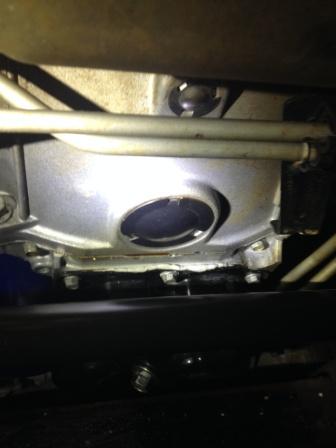

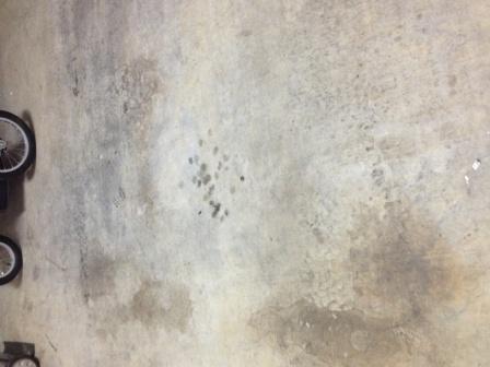

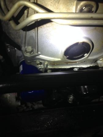

Hey, I'm hoping some of you with more mechanical knowledge than me can help with my issue. I bought my truck in February of 2016. I've enjoyed the truck, but after my second oil change at the dealership (10,000 miles) I noticed some oil drops on my garage floor. I've taken the truck to the dealer 3 times to fix this issue, but the truck is still leaking 3-4 drops per week. Each time the explanation is that the sealant around the oil pain is leaking. I'm attaching some pictures to hopefully help diagnose the issue. I'm taking the truck back to the dealer again today. Thanks for any help or suggestions.
Oil pan gasket, oil filter gasket leak, or rear main seal. Wipe it off real well, start it and let it idle for 20-30 min to see if you can catch where it's leaking from. When you drive it, the wind can make leaking fluids look like they are leaking from places they are not. Then take a pic, show the dealer.

Brian's advice is good IF you were going to have to repair it yourself. Take it to the dealer and let them figure out where it is leaking and then fix it. That is why you have a warranty.

Hence why I said take a picture of it and show the dealer.
I'm missing something. If this is the explanation that your dealership is providing, then why didn't they repair the leak?
They've told me it should be fixed each time I've taken it, but it still leaks. I think it is something other than a oil pan seal because they've said that was the problem 3 times.

Just wanted to update my topic. Thankfully at the 5th trip to the dealer a technician found the source of the leak. The explanation on the invoice was "oil leak from engine block plug number 4." Thread sealant was applied, and the plug replaced. I haven't had a drop of oil leak from the truck since that visit. Truck is under warranty so I didn't have to pay anything, but I'm glad the hassle is over.
