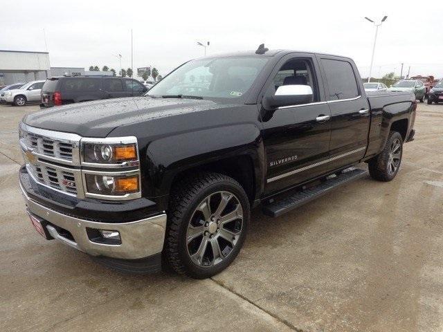

when you pick it up , have dealer check it . I just had by computer updated for the air bag. took about 15min. we want photo's of your NEW truck
