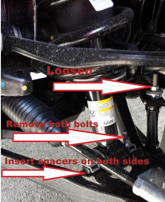

Jack up the truck on the frame where you would place the factory jack and use a jack stand to support the truck. Don't jack up under the control arm. Remove wheel, loosen anti-swat bar nut to the end of the bolt, remove both strut/shock bolts from the bottom of the lower control. Go to a machine shop and have 2 spacers 3/8" tall (aluminum, stainless or steel) with the same diameter as the bolt. Push down on the brake rotor until there's enough space to place the spacers between the shock mount and the lower control arm (easier with one person pushing down on the rotor while the other places the spacers). Get 2 new longer grade 8 bolts from hardware store and replace the stock bolts. Retighten all bolts. 3/8" tall spacers will raise the leaning side a tad over 1/2". Check alignment after. I did this and had no problems and it worked perfect.

Very easy fix. I had a 2011 Sierra that had a 1/2" lean on the drivers side brand new.

No problem bud. I don't know how tech savvy you are but tried to explain it in the easiest way. Let me know if you have any questions and how it comes out.

No need to mess with the rear or the upper part of the front strut putting the spacer there. It can be easily done from the bottom in much less time and hassle with the same results.

I have the stamped welded control arms, not a believer of adding a spacer on them, would rather do it upstairs and no one will now any better. Either way will work just a matter of preference for the OP.
