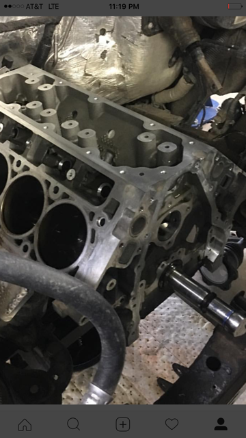

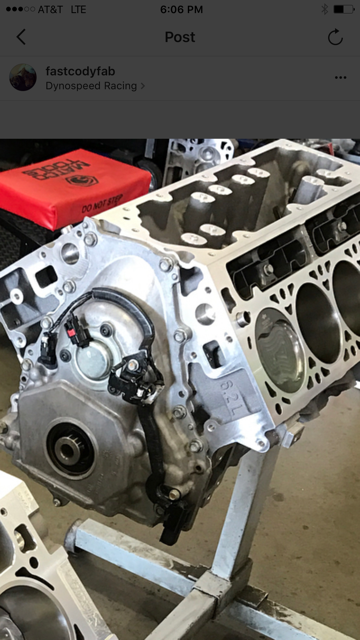

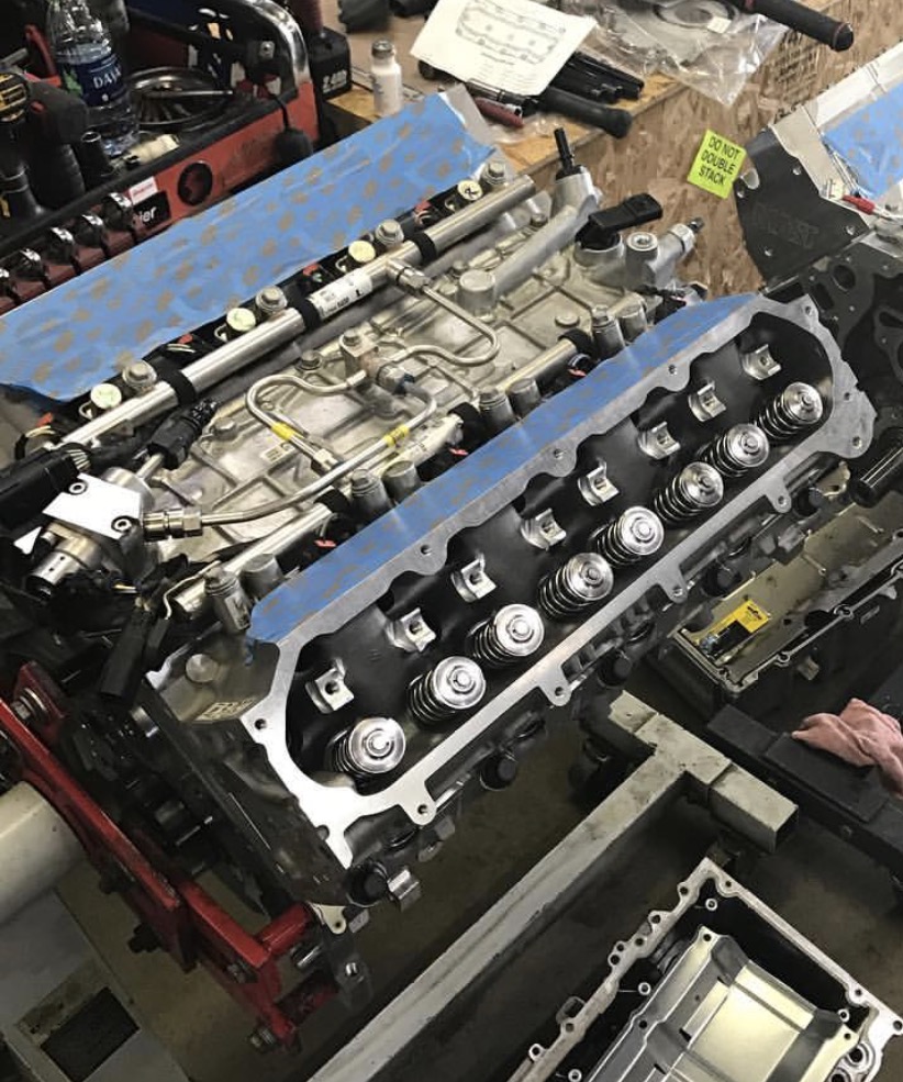

Man that sucks. Two motors gone before the supercharger was even used? Should be a lot more potent with a built 416. Now your going to want to ditch your blower and go procharger F1 lol. Keep us updated.

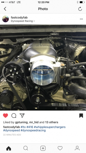

FYI to anyone with a Whipple I've been in contact with innovators west and they have been working on an 8 rib setup for the ecotecs I will have it as soon as it's available (hopefully with 10% overdrive balancer). Just emailed Whipple to get a quote on all the related pulleys associated with the blower side of things. Should raise the capabilities of the 2.9 setup a great deal. I'll prolly run my 3.625 pulley for a while to get the tune dialed in(that's still almost an inch smaller than what they send in the kit as default) but after that I'll be dropping to a 2.75 or 3" depending on if the balancer I get is 10% or not.

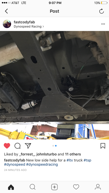

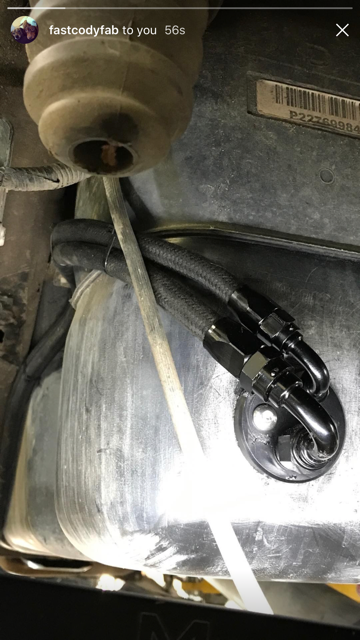

Ordered the cpr low side fuel system and a 258mm circle d a2 converter

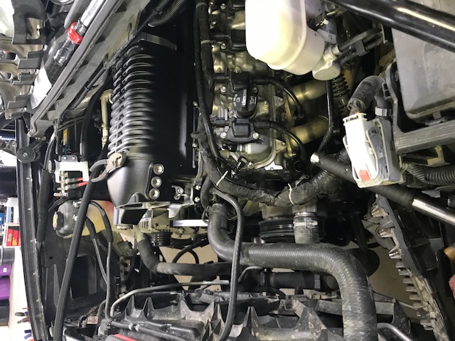

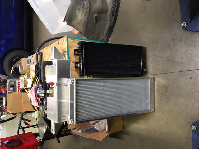

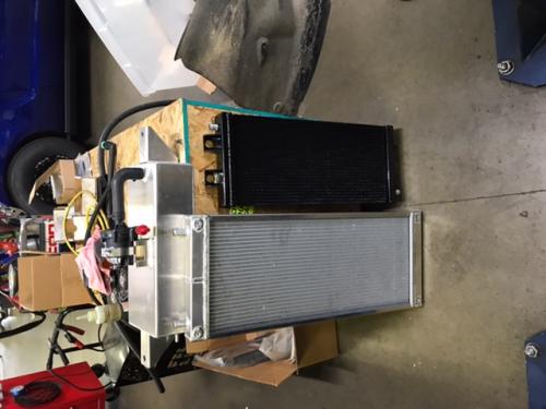

We were able to fit a much larger dual pass ic heat exchanger than whipple sends which I'm pretty pumped about. Specd by fast cody and made by four seasons radiator in Memphis
Of course the Black hx is the whipple

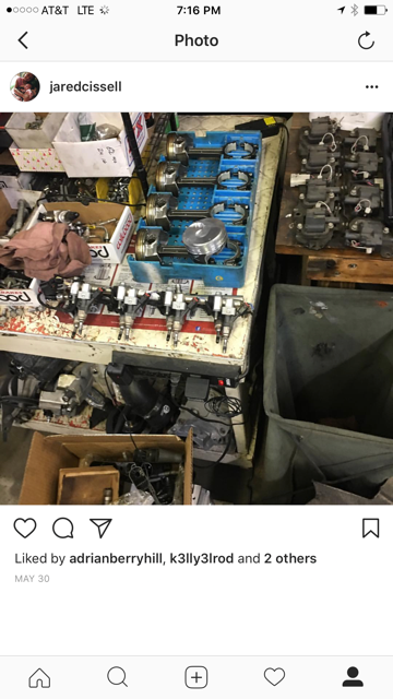

Also I had bought all the stuff to do the iat breakout but it was included In the kit. Also came with a varimax pump. They were doing wiring today (meth system, fuel pump, ic pump). Still have traction bars and gauges to install then we will be up and running
