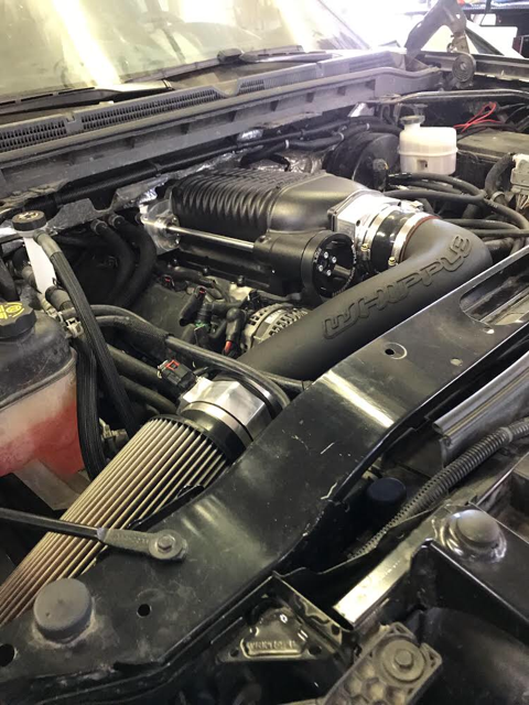

It has been a long road but we are nearing the end! My mechanic had to have the valley plate machined .030 where the hpfp mounts as that's how much shim we required and no one makes one. I like this method much better
Also they had to cut the section of ports on the plenum where there are clearance issues with the lt4 pump. Cody refabbed the area beautifully! Whipple claimed it would be a year before their casting design was updated to include clearance for the lt4 pump. I have some pics and a few more vids I'll post asap but we are waiting on a different methanol tank then we will be breaking it in.
I can't express how much I have loved dealing with Josh Elam and dynospeed racing. I literally pulled up with a builds worth of parts in the truck and he just handled it. Well
Final Rundown:
Tsp forged 416 short block dead on 10:1
Tsp Cnc ported stock castings. Stock valves
Btr .660 springs
Straub bushed trunions
Btr 3/8 custom length pushrods
Morel drop in lifters(stock diam.842 if my mind is working right )
Vengeance spec'd cam cut by cam motion(32% fuel lobe)
Lt4 hpfp(Machined hpfp mounting pad in lieu of shim
Modified whipple plenum to clear hpfp
Lt4 injectors
Cordes low side pump setup set@72psi
Katech 103tb
Modified whipple crusher inlet to 4" maf adapter and biggest filter that would fit
Whipple 2.9 running 3.625" pulley
Custom larger and dual pass intercooler heat exchanger
Circle D billet 258mm multi disc converter
Alky control meth system dual 15gph nozzles
Kooks 1 7/8 headers into ory into full 3.5" single
Big Elite dual inlet catch can
Firecore plug wires
Etc.
Well good news innovators west beat me to the 8 rib pulley setup I'm about to call them and finalize an order for one of the first kits. 15% od lower and 3.00 upper. Always wanted to say that lol (upper /lower ) shooting for melted pistons and bankruptcy@ the wheels
