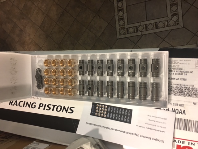

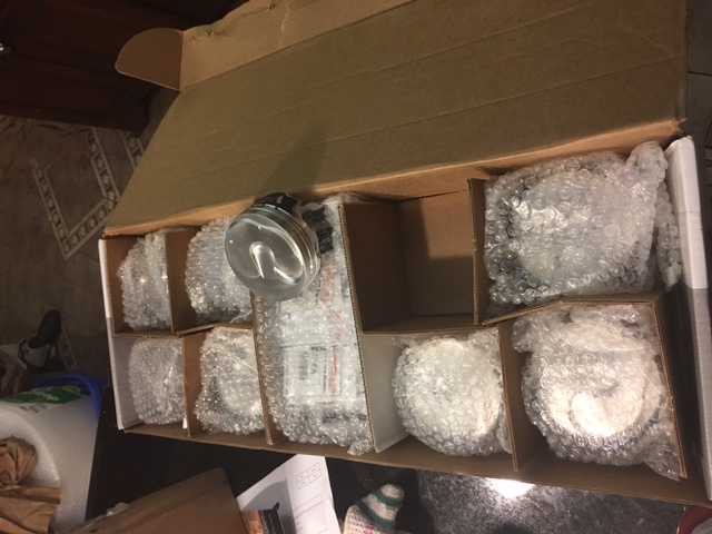

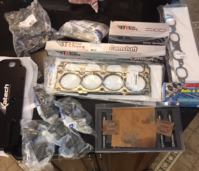

Ok so this is some interesting info. If you read the whole thread you came across a post about my engine having a cracked piston yada yada well get this. My new engine already had a cracked piston at 3000 miles. Went to put the drop in forged pistons in and Found a gently scored cylinder....number 1 same as before.
Whether it be the tune by Lewis that caused it or an injector or just bad gas...I don't know. But I just dropped 8k on a Texas speed 416 and head porting.
