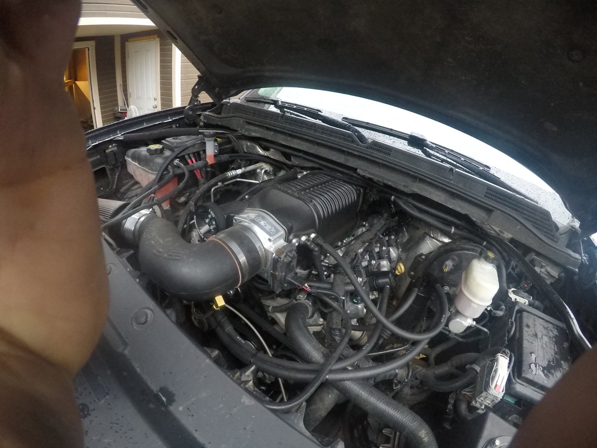

I collected all parts and have been there for the shop along the way and have spoken to every big shop and manufacturer OWNER Over the last year.  The shop is an ls based shop and th owner rides a c7 zo6 with a pro charger.  He and I along with the tech fastcody have learned alot from each other and its been a hell of a ride.  I am not one to boost or brag on my knowledge but yes.  I speak genV.
I'm finalizing the 8 rib pulley setup from innovators west (od balancer and 3" upper). And speaking of the trans I have my spare 8l90 on its wa to Tim king for him to play with and see what he can come up with as far as upgrades.
Since you speak gen v what do I need to do for a (reliable) 500 rwhp DD on my 17 6.2?
Depends on your goals and how much you want to spend.  For 500 wheel you could stay n/a and do heads and cam with the c7 intake and headers/full exhaust. That would most likely be a little over 500whp to more than 550 depending on cam choice and tuner. Cost would be about 5k out the door minimum
conversely you could keep the entire truck stock and slap a whipple on it and be at 500 for about 6500-7000 installed.

Oh and as far as heads and cam I would like to recommend u talk to vengeance racing and let the owner spec u out a cam.  I had gotten Brian tooley to spec one out and got Ron at vengeance to give one as well so I could compare the two.  I am glad I went with the vr grind as it’s way more aggressive than tooleys but is still tolerable idling around and light throttle.  My circle d converter makes sure I never have to worry about low end sogginess anyway

the truck was doing great hit a 4.3 0-60 on the 37” and was ready to lower it down, got all the parts to do the 15” conversion, and ordered 30 gallons of methanol, and something gave way in the cam drive (still tbt). At least will need some valves and a heavy inspection as well as a new timing setup.  This sickens me to the point I am doing a Katech vvt  delete front cover and ls3 timing gear. C7r chain.  Also I have the 8 rib setup with 10% od balancer from iwest coming Friday and waiting on a weapon x 3.00 pulley with griptec and whipple is sending me a 2.75 which I’ll send to zpe.  I’ll have to be careful with either as I’ve already established it will zing up to 7000 which would put blower speed at 18481 @6700 with the 3.00 and 19309 same 3.0 at 7000.  The max speed recommended by whipwhip is 18k. I’ll set my limiter at 6400 with the 2.75” and be at 192xx.
Who knows what boost and power will do but should be 14psi if I’m running 7 now with a stock lower and 3.625 upper
