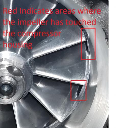

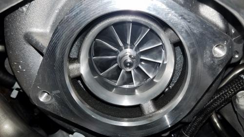

I visited the dealer today to witness the carnage first hand. The shaft in the turbo has a ton of play in it, it basically flops around in the housing. You can hardly turn the turbo shaft by hand, I would imagine some sort of bearing failure happened here. The impeller has definitely been compromised and visual damage is evident where it has touched the compressor housing. I can only imagine the pieces of the impeller that are now missing are in the charge cooler? Also, is it safe to assume that some of the bearing material has made its way into the engine via the oil return line? I'm most curious to see the exhaust housing after the turbo is removed to see what have made its way into the exhaust system.
