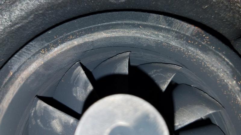

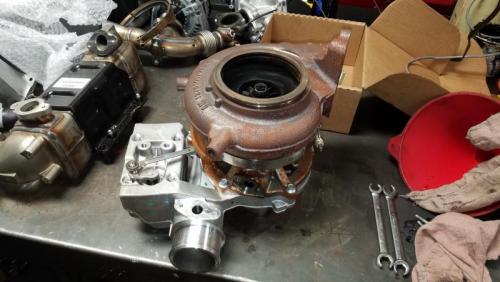

I visited the dealer yesterday afternoon. They tell me that they have ordered a new charge cooler and will clean the cold side piping, upon my inspection I found the cold side piping covered in oil and littered with aluminum fragments from the compressor wheel. The turbine wheel is also damaged and I am fearful that the catalytic converter also has some debris inside of it? When looking in the drain port for the turbo, if you force the shaft to spin it looks like the journal bearing turns with the shaft and is partially seized.

Additional pictures from my last visit to the dealer. Note the damaged turbine wheel and oil/metal speckled in the intake tubing. I tried to take pictures from inside the bearing assembly but they didn't come out very well.
Not sure how similar the VW TDI turbo is as far as air routing, but when the turbo gernaded, lots of damage. And most was in the exhaust system. I would not be surprised if your exhaust system has some damage.
