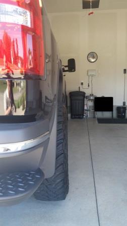

Here are 18x9 Fuel +1 offset with 285/70/18 Toyo muds. Barely fit without trimming. I have a key lift cranked 2" up.
