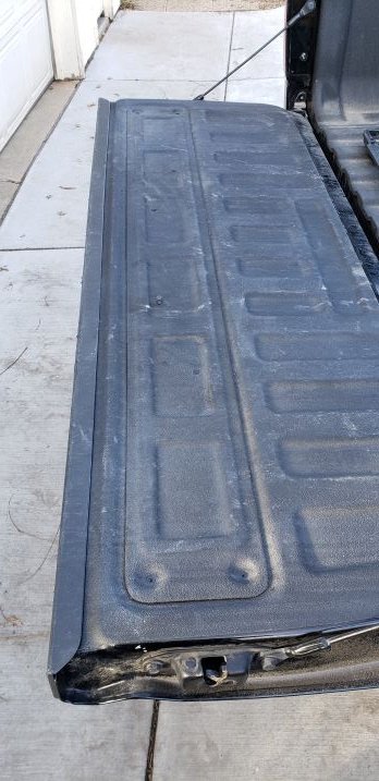

Below are pictures of me disconnecting the tailgate power lock on my '18 Sierra SLE Elevation.  My backup camera still works.
1. Unscrew the tailgate panel to expose the handle assembly.
2. My bed has spray-in liner, but the screws came out easily.

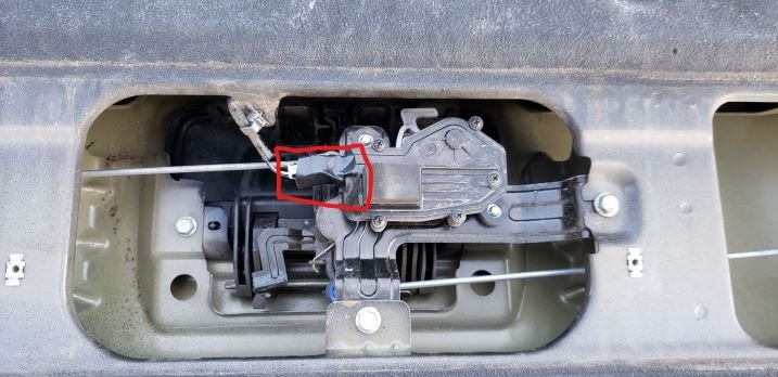

3. Locate handle assembly in center of tailgate (red box)
4. Slide the gray hold pin of the electrical disconnect to the left (red box)
5. Slide the electrical disconnect to the left (red box). This will disconnect the power to the lock.
6. I used electrical tape to seal up the open electrical connections, and taped the electrical connection to the assembly so it doesn't rattle around.
