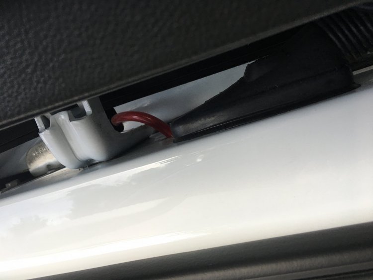

Ran power wire through passenger fender then just above door harness. There was just enough room in door sill channels to fit amp power wire all they way to back wall. No drilling required.

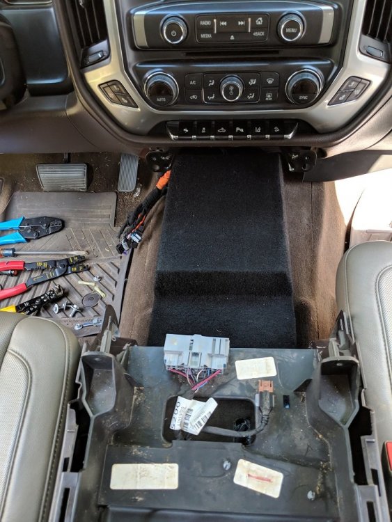

I got it installed over the weekend. Sounds good. Much more thump than the stock bose sub. I also did the rear seat fold down mod so I can get to the amp and LC2i for easy adjustments.

Soo...  having never torn apart one of these consoles, if you put your amp inside the console where the current bose sub is, can you pull out the inside of the arm rest part and reach it to make adjustments?
If you put the new sub in where the Bose sub was like I did then there isn't any room to mount an amp under there anywhere. Even if there was there would be no easy way to access it without unbolting the console or cutting part of it open somewhere.
