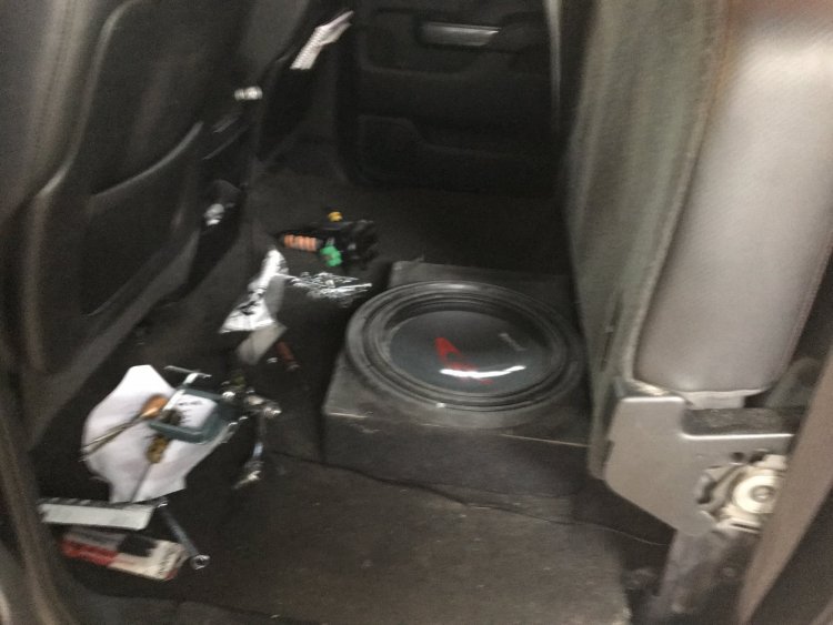

Or you could do what I did - Sub floor mounted 2.5 cu ft subwoofer box, Alpine Type-R 15", uses a minimum of under seat storage area.
The box fit right in front of the fuel tank and after covering it with fiberglass and undercoating it looks almost OEM (and you only see it if you crawl under the truck).
Obviously a major fab job including cutting a 12" square hole in the floor but I thought someone might find it interesting.
(hole was framed with 1/4" steel and is much stiffer even with no box mounting than the original 20awg flat steel in this area. Upper and lower box sandwich the frame and clamped with 12 bolts).
Sounds awesome and will massage your brain out if you put on rap music. Funny thing is I'm all about hi fidelity and usually listen to light jazz, but I tend to get carried away with things.
