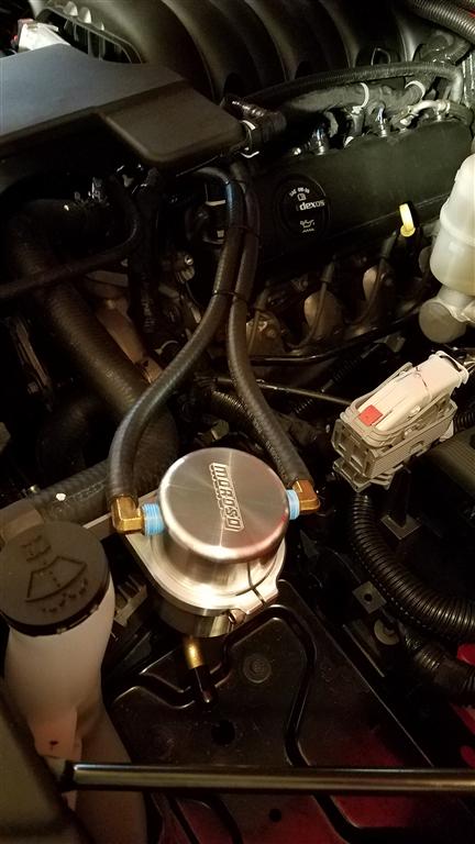

Installed my Moroso catch can on my 2016 silverado about a month ago. 900 miles later I drained out 4oz of oil and other "stuff". I'm convinced! Now, I only wish I had installed it the day I brought it home from the dealer!

is there a drain on that catch can or you have to take it apart to empty?.... thats crazy what came out of it...
Is that the part that replaces the oil filler cap? The member I'm getting my can from has that included
Yes

Looks like a badly poured beer haha. Damn only 900 miles huh? Clean install too

That looks like mostly condensation unless that's oil at the bottom which looks very clean. I really want to find out how important that clean side seperator is though. I guess it is if you have your foot in it all the time like towing up a hill or running 1/4 mile stuff (but with a truck??). It certainly wouldn't hurt anything.
The clean side really only comes into play under WOT events. Maybe, and I emphasize MAYBE, 5% of any oil ingestion at most can be attributed to a lack of filtering the clean side. I have never quite bought into the idea that the clean side is all the critical. But on the other hand, I have been a firm believer in catch can for the dirty side for years. All of my vehicles have had them for several years.
That's what I think too. Maybe towing up a long hill it will really help as you'd have low vacuum for an extended period but short WOT, I doubt much oil mist would even make it up to the air box. With DI now, I'm going to be adding one for sure.
Unless you hit a couple WOTs a month. Then it sure does keep her clean and do it's job. :driving:
But agreed, kinda pointless if you don't floor it at all.
While I haven't found enough justification to go with the clean side filter deal, that doesn't mean it is worthless. It is not a waste of money. Not nearly so compared to the useless crap some will spend on for their pickups that has no appreciable benefit. If it helps one to sleep well at night, then by all means, get the clean side also!
