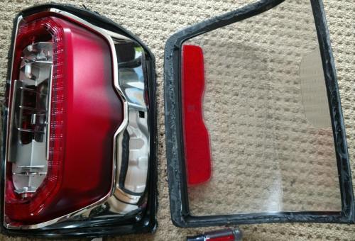

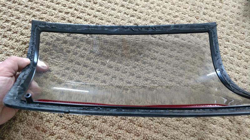

Anyway, I've just finished dremmeling the second light housing. The trick here is to keep the cutoff wheel right on the inside edge of the outer light lense as it's already black so if you screw up a bit it's not noticeable, (see pic), if you go too far the other way, you'll hit the chrome. Also be careful of the two plastic screw posts on the corner.
I found that you don't need to cut too deep or all the way through the plastic. Just take a flat head after a aggressive score and pry around the edges to pop the remaining material.
All the remaining melted plastic will be sanded down before final reassembly w/ some epoxy.

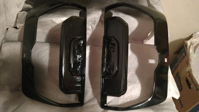

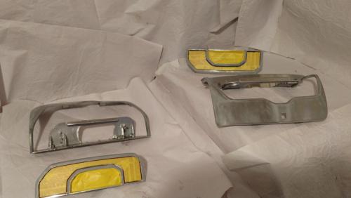

I've got the 1st set of chrome pieces wet sanded (400g) and ready for paint. Hopefully this goes well so I can close these up today!
Looking really good. I have a feeling you may have given me a new project to start over here LOL!!

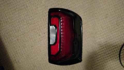

That looks awesome! Can't wait to see them put back together and on the truck!!
How confident are you that expoxy will give you a leak proof light?
Nice job btw!!
Looks good! I would be afraid to tear apart the taillight like that. Props! Id rather just tint them a bit :) Can't wait to see them on the truck.
