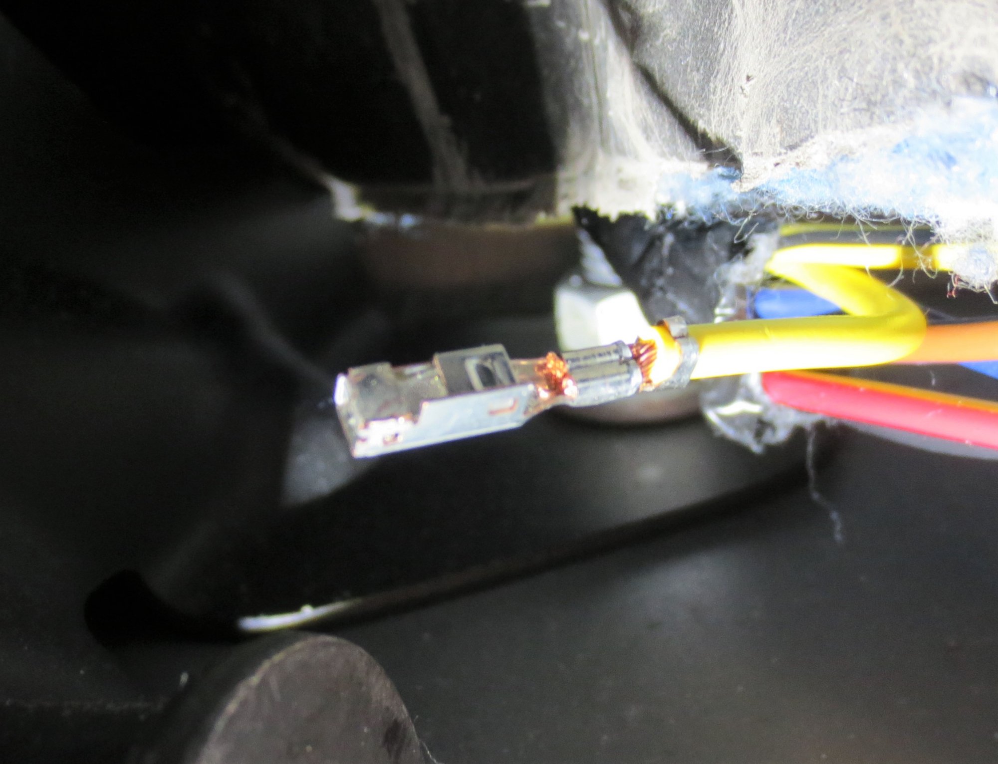

Anybody know what type of terminal this is? The connector it belongs to is for the Bose amp connector X1. 2015 Silverado 1500. Tried GT 280 female, but it won`t fit in the connector.
