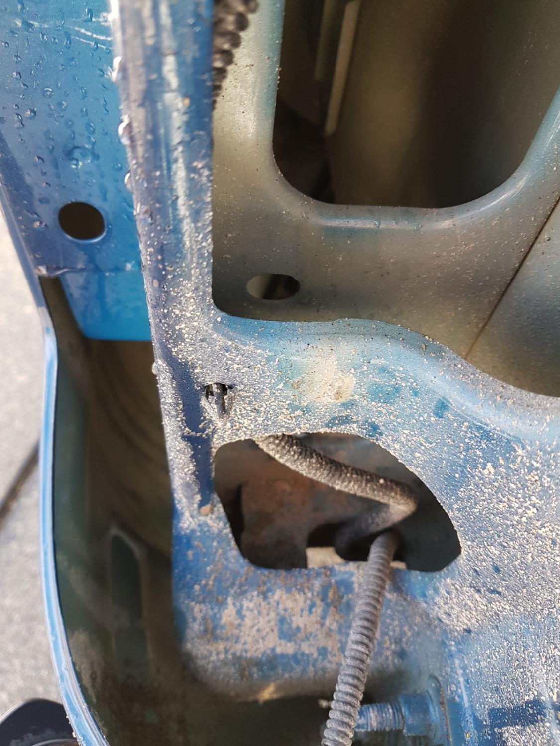

Swapping the back up lights today & came across this:
2017%20Silverado%20HD%20Tail%20Light%20O
This is after almost 3 months of service & about 2,000 miles (the LH side was the same). I seem to recall the GMT900s having a 'ribbed' plastic part between the wheel well & the rear of the box side (I could be wrong though). If this part was present, was it to prevent road spray from spreading?
My brother has a '16 Sierra HD w/ the liners. The nephew is going to pull 1 of the taillights & see what kind of mess is behind it.
If the liner doesn't make a difference, I'll just make a point of pulling the tail lights in the spring & cleaning the sand & salt off.
In the past I was well aware of making sure to wash the upper portion of the wheel opening where the 'wheel house' stamping & outer panel are spot welded together.

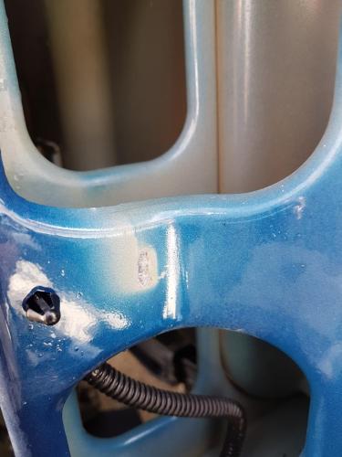

Looking today and there are already 4 holes pierced in the 'inner' stamping.
2017%20LH%20Rear%20Wheel%20Opening%20-%2
(1 of the holes isn't visible)

I finally had time to look in the tail light openings, wasn't all that bad just sand. 4500kms. I found little spots on both sides sides of what seemed like paint wear off. I washed out the voids and sprayed Rust Check on the spots before putting the tail lights back on.
