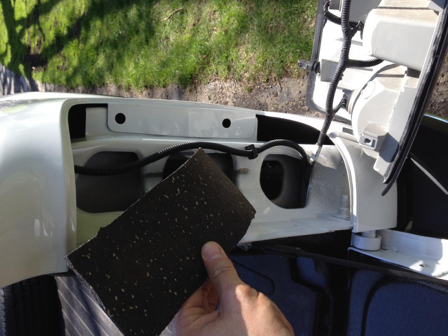

Guys I figured out a non permanent fix for protecting the tailights from mud...
I cut a piece of 1/4" rubber mat into 14.75" x 3.75". Slipped it in between the sheets of steel behind the tail light, then fold the top over itself to pin the rubber righty against those gaping holes. Now I can still remove my "mudflapps" to wash the upper wheel well/body panel joint.
Tried posting pics but too large
one easy way to resize
send the picture from your smartphone to yourself (email or text) and select a smaller size before you hit send, then use that one ...
Sorry for the sideways pics but y'all get the idea. The rubber was from a friend. He bought it by the roll to place in his home gym to replace the carpet. Very handy stuff
