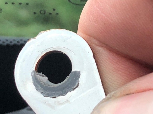

So the next day after more looking around and visiting my dealer I find out that it is on top of the dash, driver side, behind the speaker. So I go home and start putting my truck back together where I tore into it and went for the correct location. I then find this...
57672-dcf6ce86123cac5824778e192eb6cbad.j

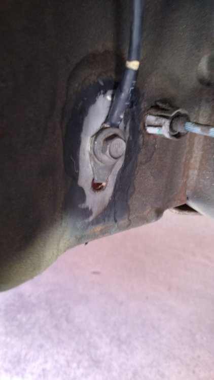

Yep that would cause a "high resistance" alright. So I removed the nut and the ground then I trimmed the sound deadening material and put it back together. So far its been 8 months since I have did this and the truck is running like a champ. ZERO issues. Here is what I did to the material, as you can see I trimmed quite a bit...
57673-b3655ee195a16c9a2b3f74515d137b73.j
Also I decided to look on the other side of the dash to the ground G210 and cut it as well, It is NOT necessary to do this but I did anyway.
57674-96a46fd4270ba1333fa312af3b798089.j
