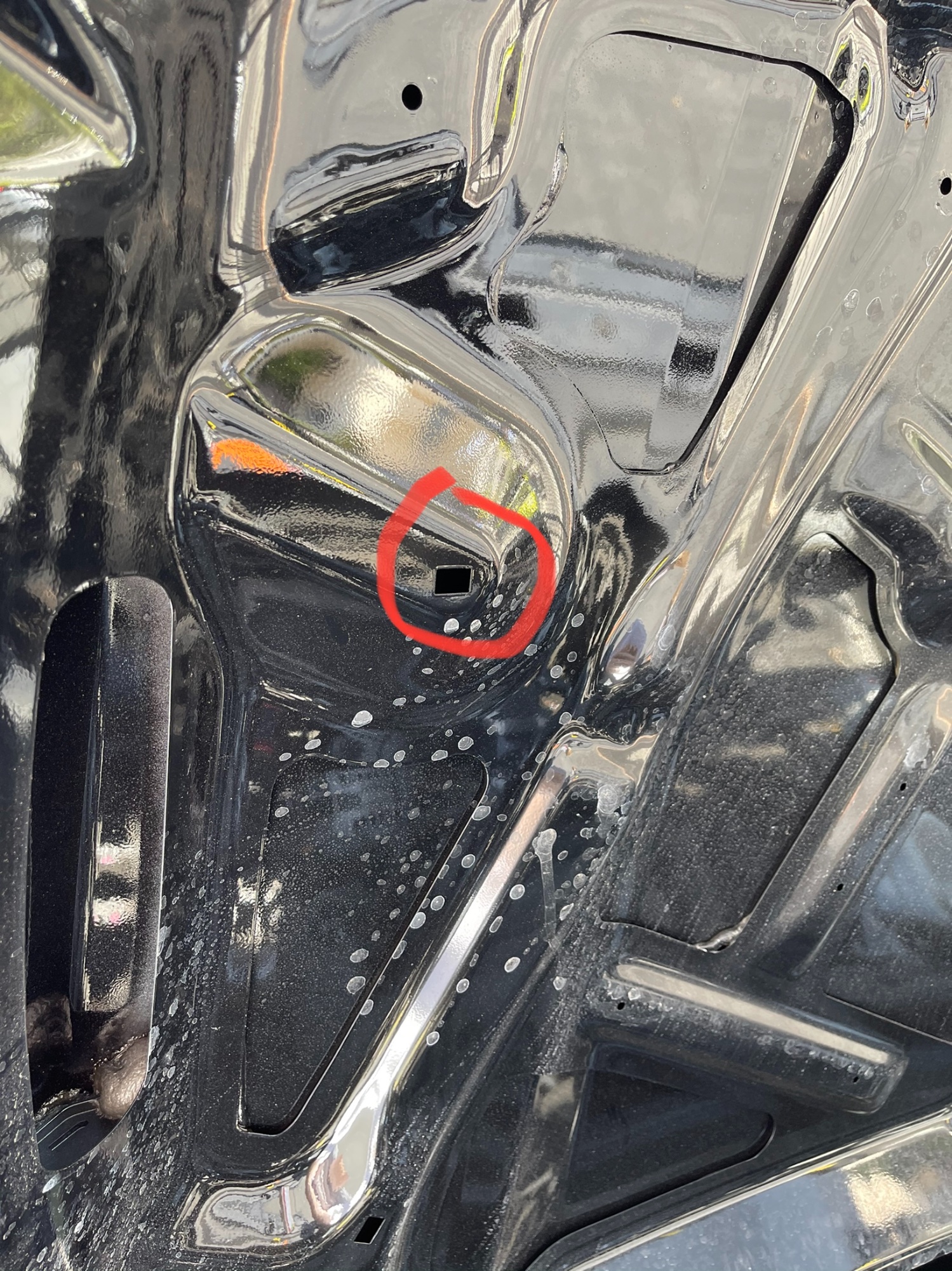

Do you know what those bolts bolt into? I thought I had everything and I see there’s nothing to fasten the bolt into. I took a picture from my install and circled them red.  Please help!! 🙏😅😅
I’m having the same issue go to advance or any parts store and get the license plate kit it comes with clips that go into the hood where the holes are and the bolts that attach to it you will also need to get some washers for it to hold the bolt in

I am in the same boat. I ordered the parts (or in some cases the replacement parts as some have been replaced by GM) from the original post. The online GM parts store I ordered them from didn't send the (6) Insulator Retainer Part Number: 11571159 which I think are push in plastic retainers for attaching the underhood insulation pad. However I need (8) of them if this is correct. Also I have nothing to go in the square holes nore the bolts to mount the underhood air duct to whatever goes in these square holes. I think they are supposed to be (8) metal clip but can anyone confirm? I don't trust the plastic license plate pop-ins given the amount of weight and that it's suspended.
I think I found the correct part, part number is 11547582
