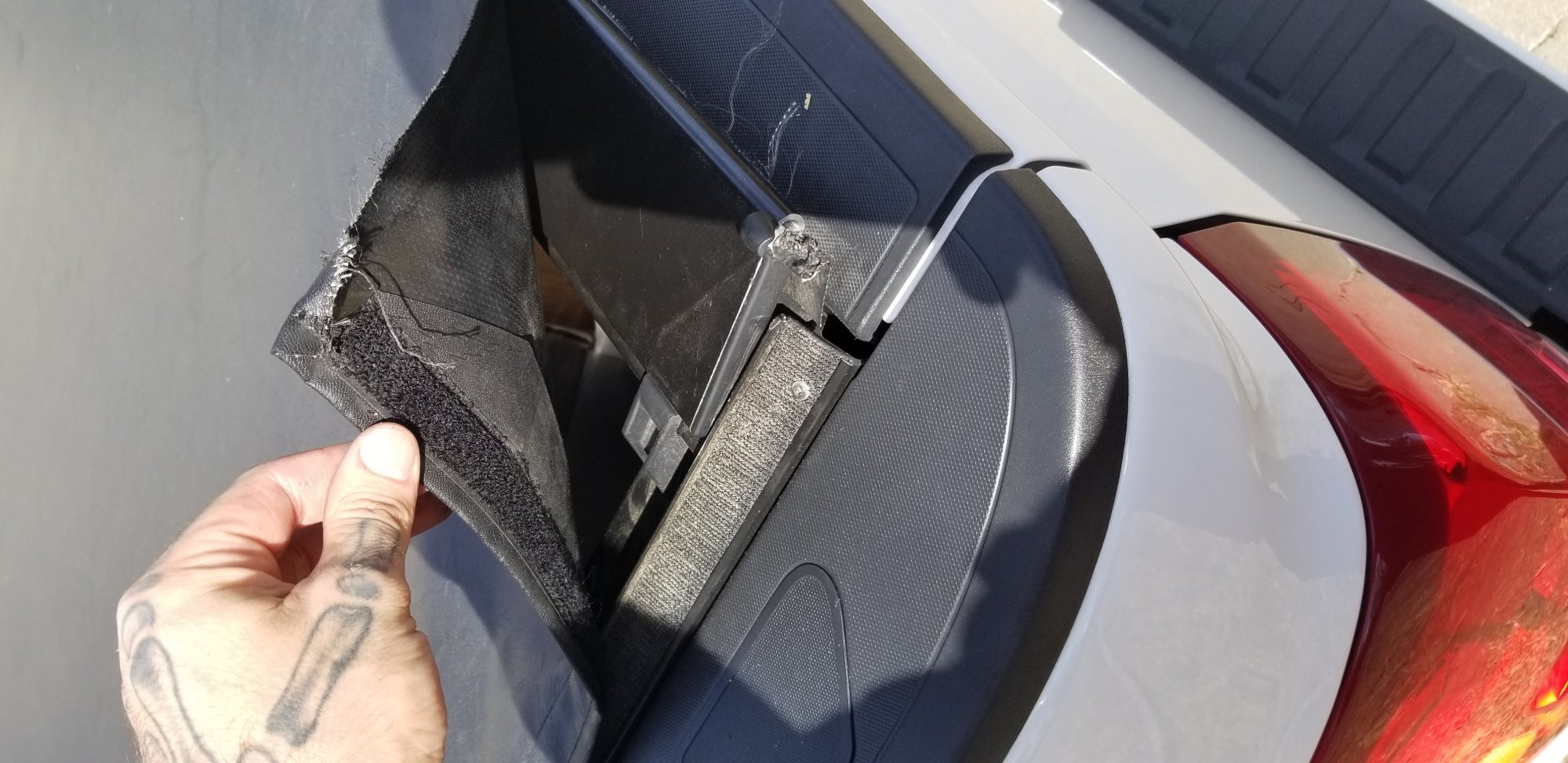

So i pre installed the backup cam.  I had to swap the plastic arm mechanism from my handle to the new one.  Didnt do it right so the tailgate wouldnt unlock.
So i had to bend and rip my soft tonneau cover in order to get in the bed
So if anyone knows of a good soft cover thats sits flush or almost flush with the bed rails, let me know
  • Sad 1
