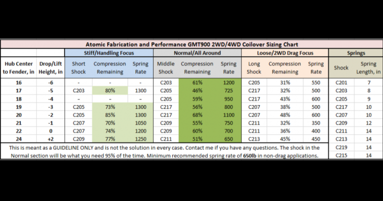

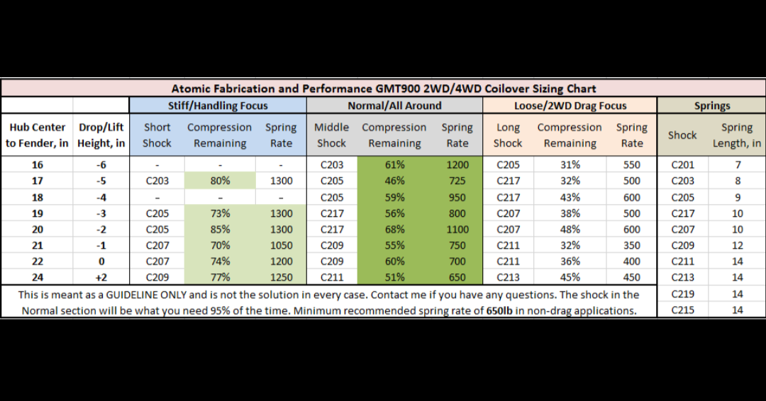

4 minutes ago, Nasty said:
rThat was a choice me and atomic came up with.  Viking said the front end of a regular cab v8 needs 630lbs to feel stock.   The spring is chosen for what you want to do.  500 for drag racing up 10 950 or 1000 for say if you were to road race. I wanted a. It stiffer than stock but not to stiff because the coilover is double adjustable to I could stiffen it up a little. So 750 ish was a nice median
Interesting. My 6 cylinder RCSB with King coil overs is fitted with 700# springs. I had no idea and could find no one willing to tell me what stock was. Nice to have a ball park number. I'll feel less apprehensive about ordering their 600# spring.  That's a big help brother. Love your truck and waiting to see your install. Happy Hemi Hunting. :thumbs:
You should be ok with 600lb but it will be very soft.  I do suggest getting double adjustables to dial it in.  The atomic brackets, and coilovers were 800 shipped.  Can't beat that.
By the way I hunted a twin turbo f150 with 2 stock turbos up to 3rd gear.  I need a supercharger and he won't have a chance :)
Edited by Nasty
I'm pretty invested in these King's but find this information priceless. Would love to know what the factory spring rates were though. No idea why they think it should be such a big secret.

I had Pepper out and about today. Been about three weeks so it was like fresh eyes. Nasty you have me convinced. I'll keep the 700# springs and continue to work N2 and shims. Thanks for the help.

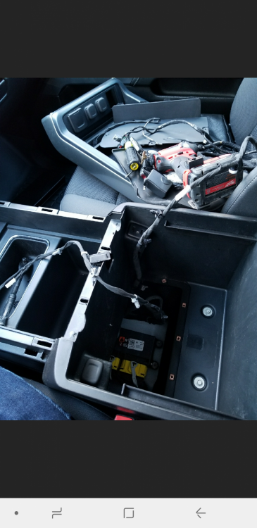

Not really an update. But I ordered a stock console harness and pgamboa conversion harness. So I'm working in that right now
Truck is back up and running like a dream
