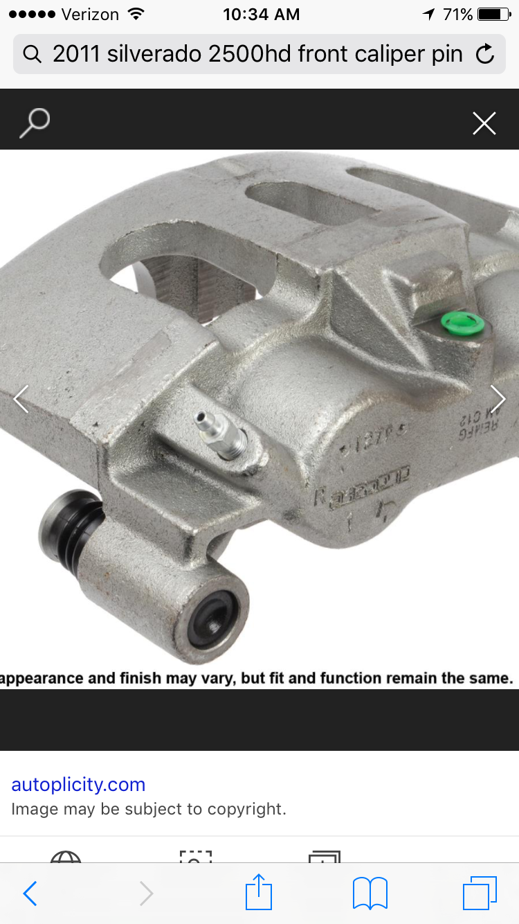

So after a long drive, put the front of the truck up and spin both wheels. Pass side slides free and the drivers side has resistance. Wouldn't it be the other way around for a drift to the right?
Pop those caps off, there is a Allen head bolt in there that's the slide pin...
The "pins" are the 2 bolts holding the calipers to the caliper brackets. They go into the rubber accordion boots in the calipers...
They should be able to easily slide in and out of the calipers and there should be grease on them as well (which is why the the rubber boots are there, to hold the grease in and water/dirt out). It's a special grease, not regular chassis grease.
If the driver's side brake isn't working well (rust problems, not sliding, bad caliper), then it may very well drag because it doesn't "float" back to free-wheeling. And then it may not work very well when you hit the brakes. The passenger side works and so it pulls to the right. At least this is one theory.
UPDATE: Lower drivers side front caliper pin was frozen. Got it out and lubed it all up. All back together and tracks straight. Drifts a bit but it may my imagination or the road. Worst case I'll get an alignment
