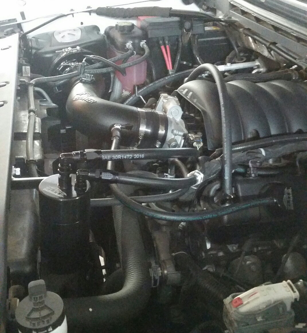

Elite Catch Can for 5.3
Anyway ----- anybody else care to answer the original questions? There must be many here who have installed on 5.3s.[/size]
Elite e2 is what i have it looks good and works an intended. I have no complaints and i highly recommend it!
  • Replies 51
I have the e2x. 2 ports it comes with 3 but 1 is plugged.
I set the bracket between the top bolt on the washer resivoir
It can be had, I believe, with just two ports.
I purchased and installed the E2 with dual exits and cleanside separator this weekend. After 75 miles i could already see fluid in the can. Very impressed so far!
It can but the one I got came.with 3. But 1 is blocked off. It's for another exit or something. But not needed
Helps when you do WOT. Blow buy. Not "needed" but will help. I have one
I just think you're getting the catch can. Might as well get the css as well
I installed mine this weekend too and its working great so far. I might be upgrading the hoses because i am getting a hissing sound coming off the clean side.
Seems like overkill if you’re not going to do any blasting around. Suppose it can’t hurt though. This is why I’m asking. Why not hook the second exit to your airbox?
I'm not quite sure where the other one goes. But the line for that would look ugly the guy I bought mine from didn't use it. So I said Meh I won't either
definitely something i was considering doin as well
I messaged Elite and they have been no help so far.. I think the consensuses is the line they provide is insufficient as higher PSI hoses to not have this issue. I installed mine with the supplied hose because anything is better then nothing.
I've heard about this and having a gas smell. Luckily the guy I bought mine from had changed the hoses already
Who did you purchase it from?
I'm running the Elite E2 single inlet/outlet with check valve and CSS.
