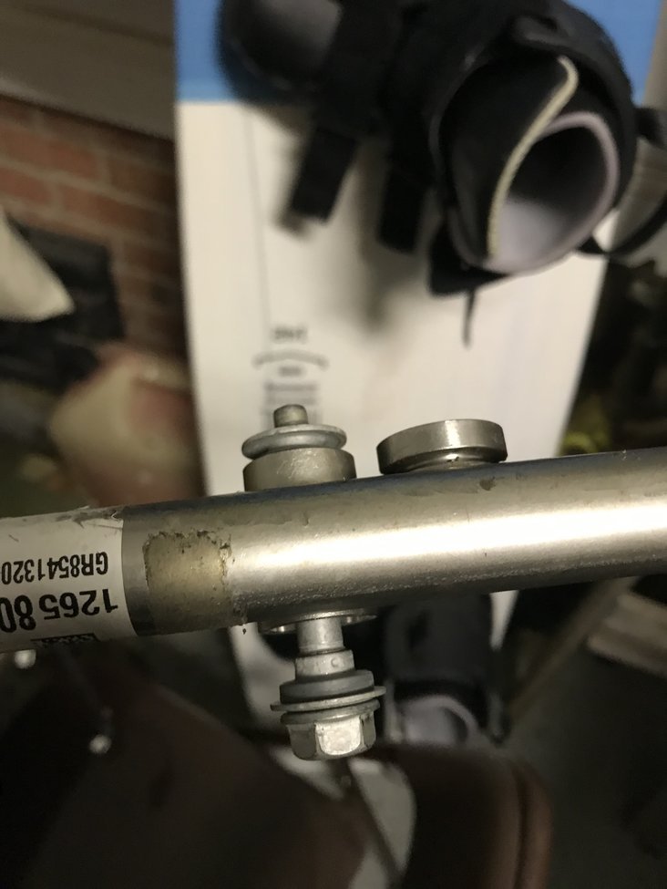

Anybody know how to swap the bolts that hold down the fuel rails to the block.  I pulled my rails and injector for a cam swap on my L86 and the injectors where stuck in the block so I bent the fuel rails getting them out.
I have all the injectors swapped but the new fuel rails didn't come with the bolts installed in them.  And the bolts on the old rails don't just unscrew out.
Any techs out there know the answer to the above.  I got the rest of my motor together now.  I'm going to try and press them out today after work.
For anyone else that run across this thread and needs to know how to get those bolt out of the fuel rail.  They just punch right out.  But you need to punch them out because you can't just pull on the washer to pop it off.
I put my old rail in a vise used a punch to lightly tap them out. One small hit with a hammer and the punch and they pop right out.
Then to put them in the new rail I inserted the bolt and place the rail and the bolt flat on the table. Then I used a socket to top the washer to tap it down into the rail.
