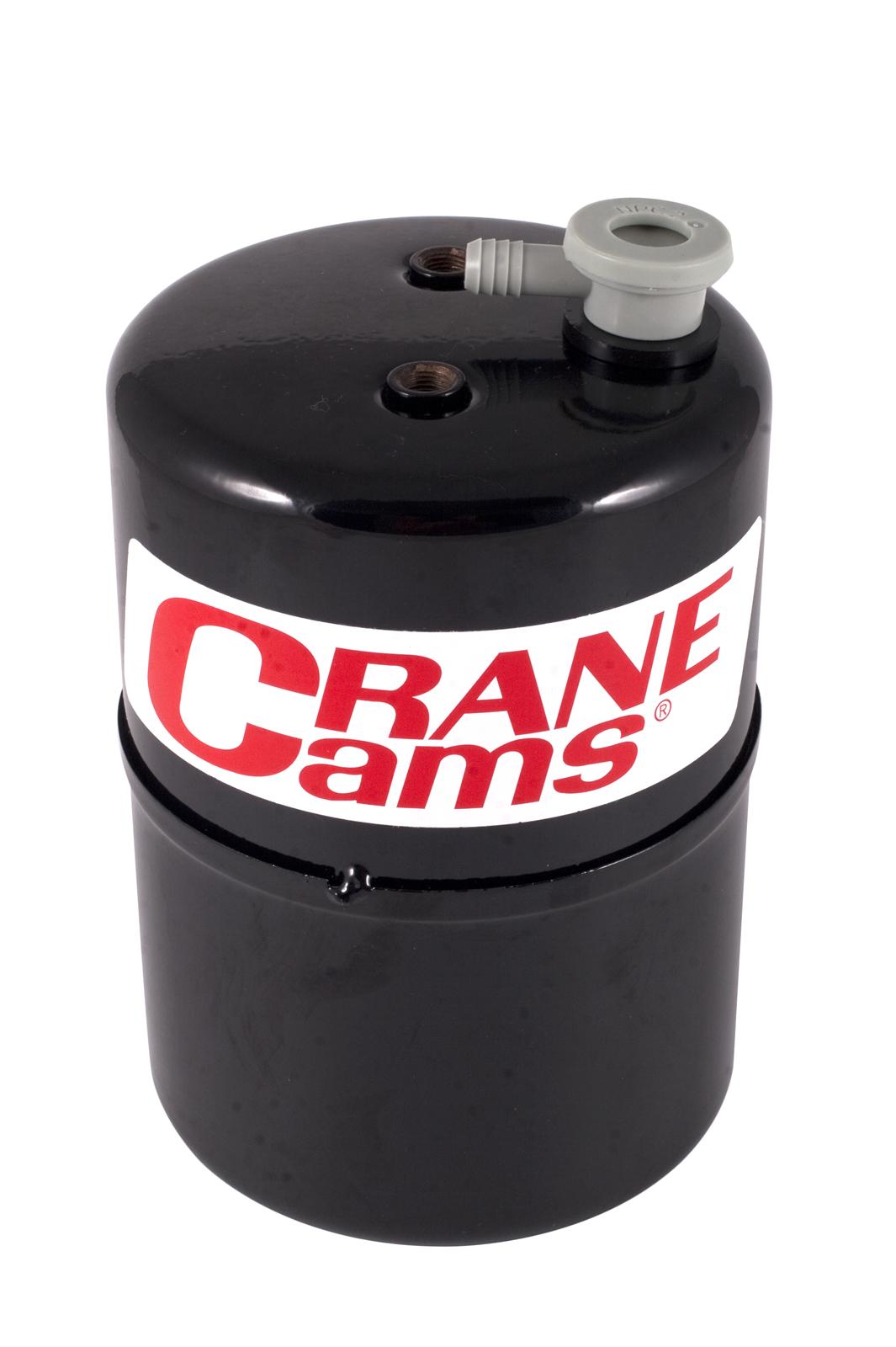

The engine does pull plenty of vacuum at times. Might be able to add a vacuum reservoir with a check valve between it and the intake manifold. That way you can build up vacuum in the tank for use in a situation when the engine itself isn't pulling enough vacuum. I've read about old muscle cars with hot cams that used a similar setup to improve braking performance.
https://www.summitracing.com/parts/crn-99590-1/overview/
These kits allow you to store the vacuum you need to use your vacuum-assisted power brakes. Crane vacuum reserve systems use a one-way check valve that will store the vacuum until you need it. The kits can be installed in tight areas, and come complete with all necessary hardware, except for the power brake hose.
