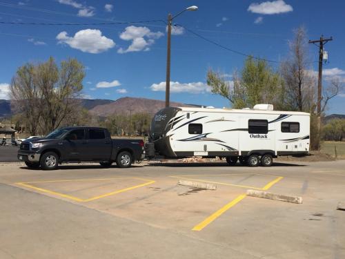

As others have stated, where you tow makes a big difference. My Keystone Outback 280RS is supposed to be ~6600 lbs (actual weight is 7200 empty), and I was well within my weight ratings for a Tundra.
This blew ass. When you finally got to your destination, it was sleep time. We were just wore out. Stopping for gas every 120-150 miles was awesome as well. We did 5000 miles like this and my wife whom tows 50% of the time threw in the towel first.

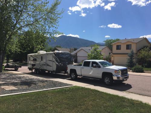

I have always owned diesels, 3/4 or 1 tons, and drank the cool-aid and purchased a Tundra. Bad ass trucks, and tow well, but just asking to much for a 1/2 ton truck.
Now, we just set the cruise control, tow haul mode, exhaust brake on and go. I have been over every major pass in CO with ease. Our next trip with this truck/trailer will take us over ID, MT, and UT passes for 2500 miles. This will be a great trip this time with a properly set up truck/trailer combo.
