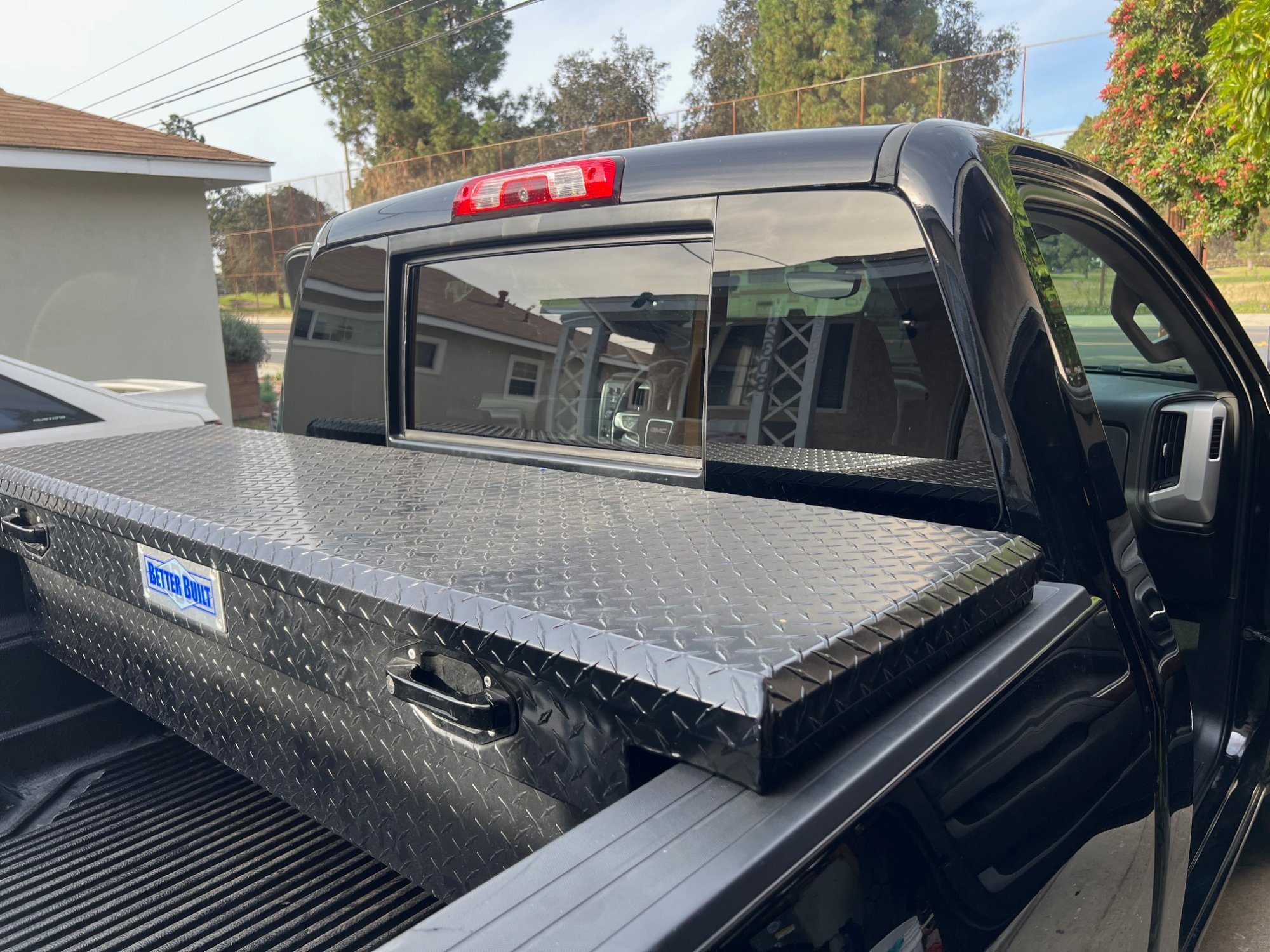

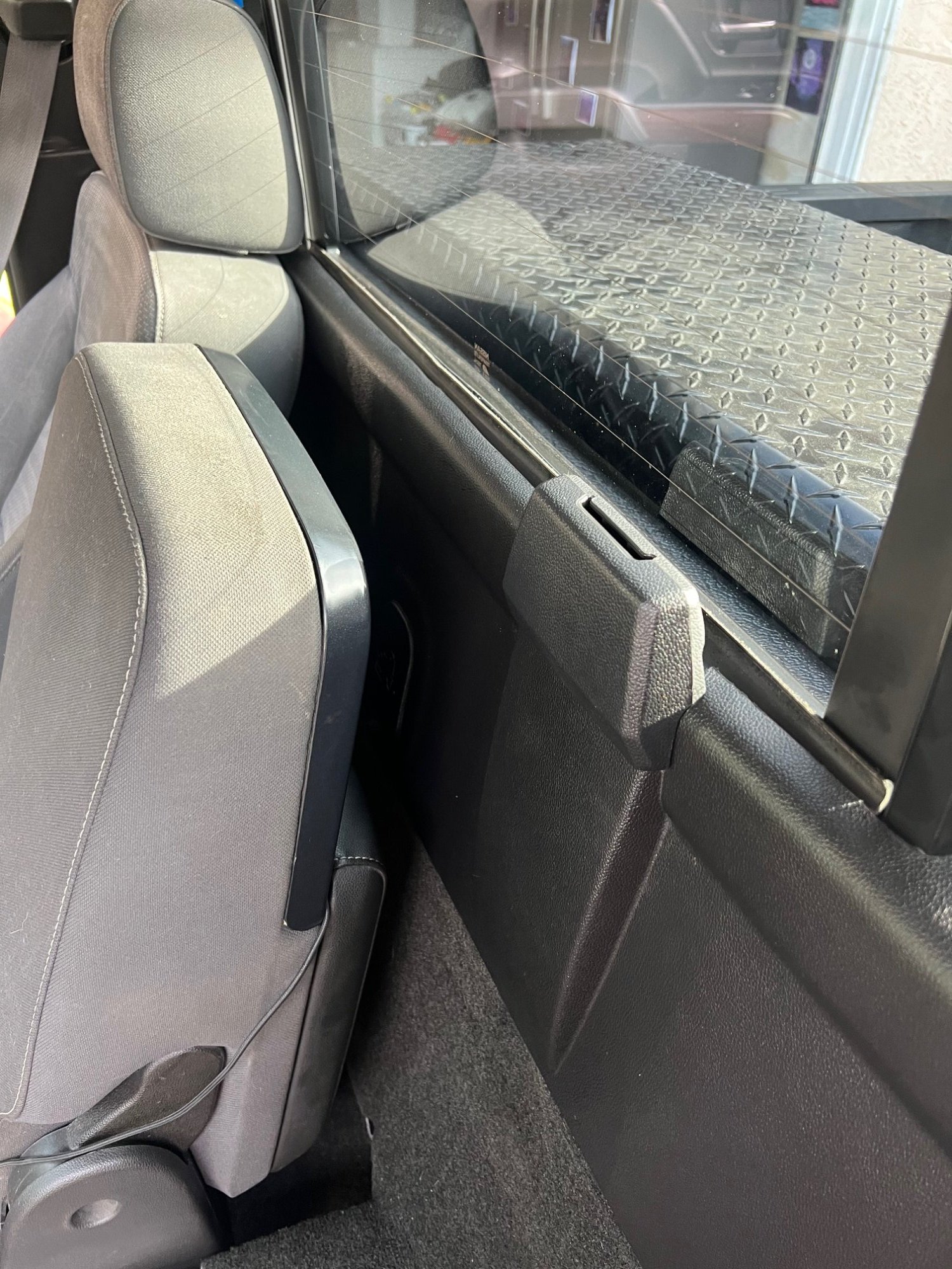

titan window
A window out of a Nissan Titan?
4 minutes ago, Anthonyvee90 said:
Yes
Interesting, didn't know that a titan window would fit

7 hours ago, Anthonyvee90 said:
wired to oem switch
I would like more information on the wiring to the oem switch. I am planning on doing this and was going to wire it to the oem switch myself.
Sorry what I meant to say was wired to oem switch location with after market button. Wired to oem switch but wouldn’t work 5 pin usually is
pin1:window motor
pin2:ground
pin3:12v
pin4:ground
pin5:window motor
but couldn’t get it to work if you figure it out let me know please
