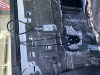

0673D505-E284-42D2-A5EE-E8843C1B8868.jpeg.95a1443e7d0884d1003527df22430c77.jpegWhat a ride. I have completed this task that was well a small pain, but seems that I am one of the few and with only having to source a few parts online and from[mention=159655]pgamboa[/mention] and his business @harnessdr
He helped me by walking me through what I had and what to check for. Seems I needed an x2 fuse block for the relay to run it as well as motor and then the studs to mount it.
I bought the fuse block from[mention=159655]pgamboa[/mention] and got motor on eBay. Seems they are hard to find.
Phil really helped me out as for 4 years I’ve wanted this option and really didn’t know which wires and where to look for them. With a few mins on a chat I was able to check each location for the wires needed and as I said got lucky that I had many of the wires ran.
I ordered the glass slider, the motor, the x2 fuse block from Phil and the upper console to get the oem switch. The last thing I’m currently waiting on is the trim right under the slider. This is different than the one if you have a solid window so either you trim to fit what you got or have to source exactly what you need.
In searching here are the parts and some quick picks. I don’t have part number for x2 but I’m sure[mention=159655]pgamboa[/mention] can help you out with that if needed. These are for my 2015 but should be at least 2015-2018. I would say 14 but was told there is hit and miss as 14 was a turnover year.
Motor 23490454
Console. Can be many as depends on options
X2 fuse block with relays
Edited by Csjumper2003
