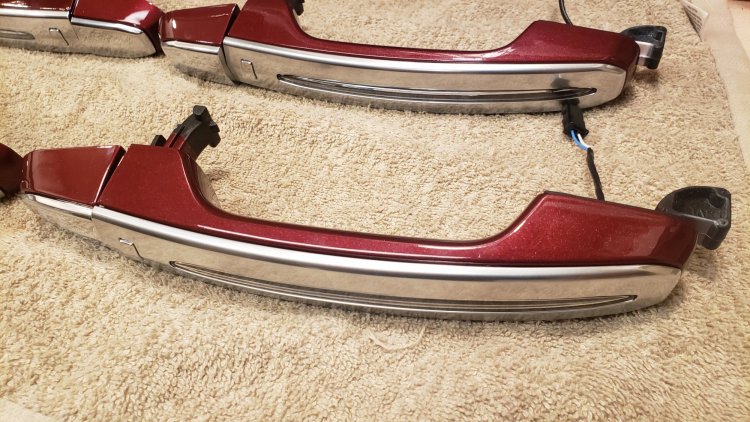

Whew... This is an old thread huh...well, like many on here, I now have the Denali cluster and swapped all the controls over to the gmc red. I've had it for about a year now. And I couldnt be happier. I've been thinking real hard to do the HUD. Its just to much money to have it. So, I'll actually have to look down a few inches at the dash.. lol... Illuminated door handles are in the works for me now though.
