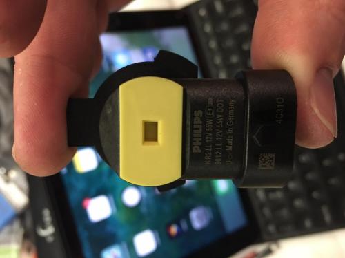

So I pulled the headlight bulb to find a PHILLIPS hHIR2 LL 55W 9012 LL, Made in Germany. (See photos).
When I compare the various replacement bulbs offered by Autozone, the replacements can range from 3000, 3200, 4100, to 4200º Kelvin.

3450K according to this post on the candlepower forum. http://store.candlepower.com/ph3rdge90h.html
