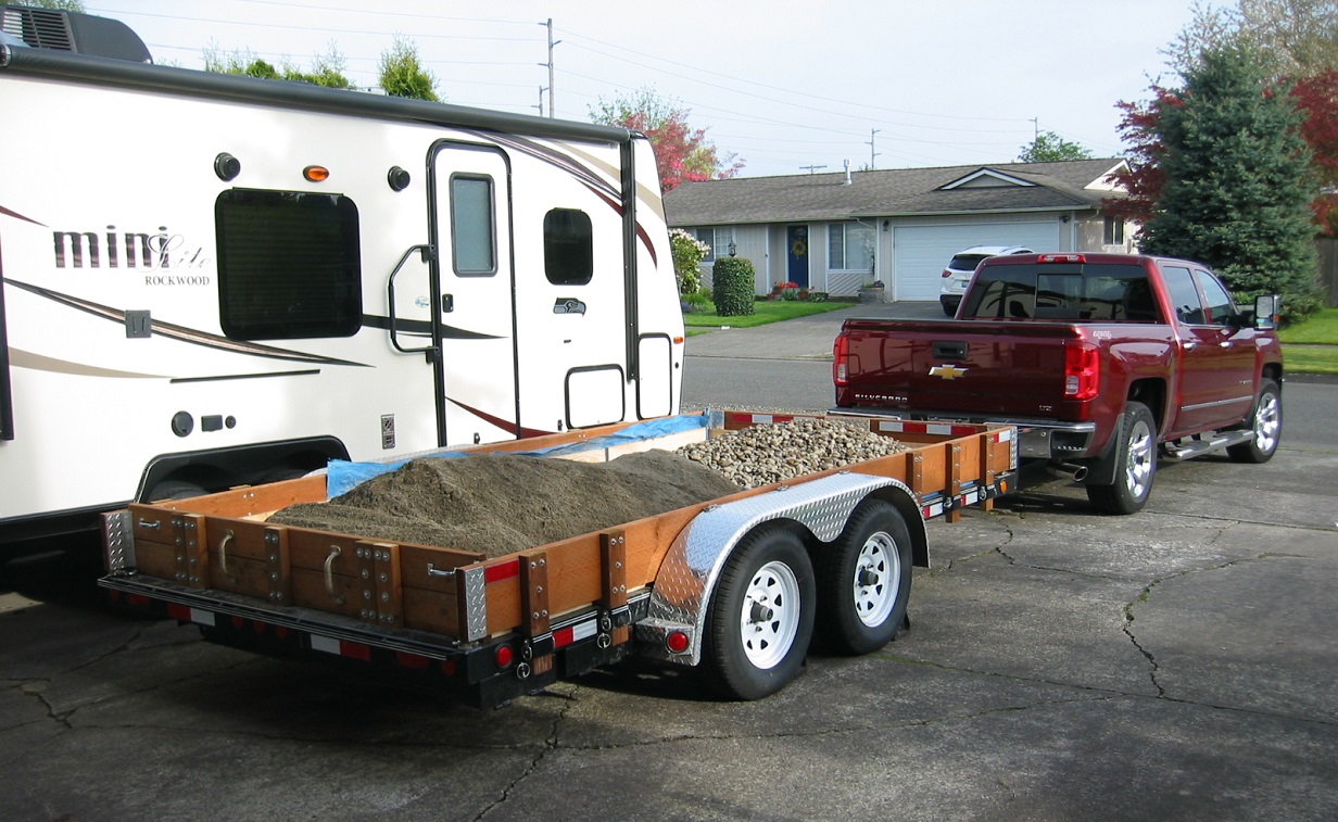

2017 Max Trailering 6.2L daily driver and tow less than 5,000 lb camp trailer loaded with 700 lb tongue weight scaled. Do notice more bounce over bridge abutments and whoop-dee-doos in the road way. Maybe an equalizer hitch would help with that - required for 7.000 lb trailer or 800 lb tongue weight. She does sit perfectly level with the 700 lb tongue weight.
Power is not a problem - revs higher and shifts more than the Duramax but that is to be expected - different beasts.
If I had to tow as close to the max rating as you are talking, I know the 2500 would handle it with more safety margin regardless of engine. I sold the Duramax to a 2500 6.0 owner who wanted more power to move his 10,000 lb boat & trailer.
Pics of NHT peeps on here towing:
And here's mine squatting with a tongue heavy load:
Normal tongue weight load:
Less than 5,000 lb camp trailer shown in back ground:
