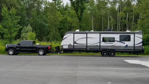

14 sierra 5.3 3.42 33 inch tires. TT 33ft hitch to bumper appx 7500lbs loaded give or take a couple hundred depending on wife's "needs" for the weekend. I'm amazed how well it tows. Would a 2500 be better certainly but I've not had any problems maintaining 65mph in the hills of So In/Ky. On 95 degree day trans never got above 210 and that was on a fairly long steep grade. For all the quirks this gem has they are excellent tow vehicles. I was expecting to have to buy a 2500 to feel comfortable but with a good hitch and common sense driving I am happy with my set up.b1f19e448a3b6a5881904acc9e0521b6.jpg

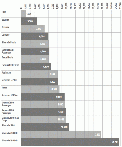

My max trailering has a 17,700 GVWR - Less 6,000 actual scale weight = 11,700 rated towing capacity. I don't even tow half that.......
GVW and Towing capacity are 2 different things. My understanding is... GVW is what the truck can carry including the weight of the truck. (the most weight can be on all 4 tires) Towing capacity is the max amount of weight the truck can tow (pull) my 17 6.2 8sp says GVW is 7600 pounds but towing capacity is 12500
