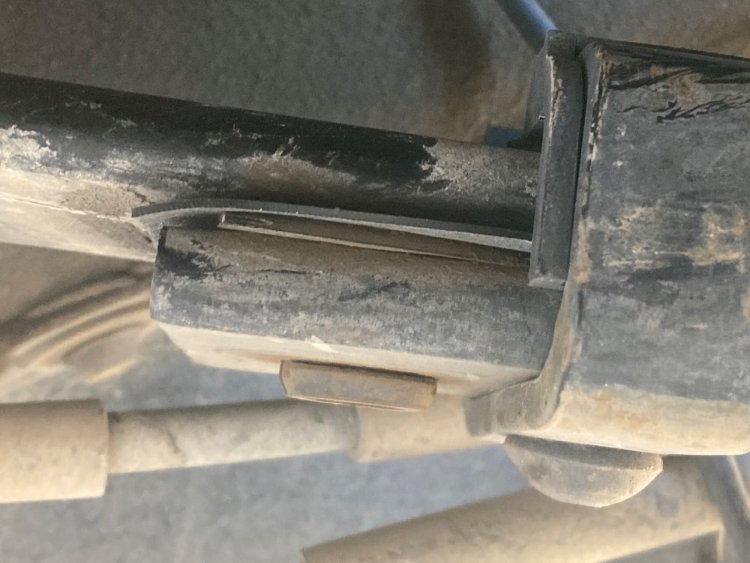

Justin101714 Posted July 24, 2017 Posted July 24, 2017 It is in the springs, but replacing the springs won't fix it, it will come back. The rubber pads in between the springs need to be lubricated with grease on the top and bottom of the pad. This will fix the issue. I've done it tons of times on the older body style and the new ones. Spraying a lubricant in there won't suffice. The springs have to be separated by shoving a pry bar in between them, lift up the pad and lubricate the bottom and then do the top. Guaranteed to work! Sent from my iPhone using Tapatalk 2
Justin101714 Posted July 24, 2017 Posted July 24, 2017 I have the same issue on my 2016 HC. Would hear clunking in the back whenever I would back into my driveway. Asked the dealer to look at it when it was in for service and they said there was a service bulletin about it and 'they tightened things up'. Problem reappeared a few days after and they have ordered new springs for me. Parts are back ordered but all covered under warranty. Sent from my Nexus 6P using Tapatalk I'm surprised they got away with ordering springs, GM is discouraging Replacement because the problem will return. Lots of springs have been sent back to the part quality center for inspection and have passed good. They just needed lubrication. Dirt and junk gets in there and it'll make noise. The prior body style did this too. Just not as noticeable because they didn't ride as quiet. Sent from my iPhone using Tapatalk

Dwp_Silveraydo Posted July 25, 2017 Posted July 25, 2017 Brought mine into the dealership last month for this problem twice. First time they tightened everything down in the rear end, took them an hour to do so. Then right when I got back into the truck and started to leave the parking lot, it did the same damn thing. Took it back a week later and they lubricated the leaf springs with some heavy duty grease and the clunk, clink, bang noise went away.Talked to the service guy and he said if the truck continues to do it, they can look into further options, or they will just need to lubricate the springs on a regular basis. A month later the truck is starting to do it again. If you spray some WD40 and coat the springs pretty good while getting the oil in between the springs it'll stop the noise for a couple of days until they get dirty. I also found that when the springs are wet they do not make the noise as the water is acting like a lubricant. Hope this helps. 2

jeck1 Posted July 31, 2017 Posted July 31, 2017 It is in the springs, but replacing the springs won't fix it, it will come back. The rubber pads in between the springs need to be lubricated with grease on the top and bottom of the pad. This will fix the issue. I've done it tons of times on the older body style and the new ones. Spraying a lubricant in there won't suffice. The springs have to be separated by shoving a pry bar in between them, lift up the pad and lubricate the bottom and then do the top. Guaranteed to work! Sent from my iPhone using Tapatalk Just as you said it would, the clunking noise has returned. Got new rear springs installed on Friday, today (Monday) the truck is clunking away again.
amxguy1970 Posted July 31, 2017 Posted July 31, 2017 Clunking is usually something other than leaf springs, usually play in the axle/driveshaft. Creaking/squeaking is the springs and need lubrication. Lubrication won't stop the clunking noise, if it did it was a fluke. There is a good amount of play in the driveshaft to axle, I hear a clunk usually every time I put it in reverse from drive. My springs creaked for a bit after going through some muddy roads a while back, had them cleaned and lubed and nothing since. Just got done hitting a bunch of passes and trails in AZ, UT and CO which had some mud so hope it doesn't come back. It is a truck so if it does oh well, clean and lube again. Tyler
