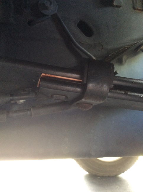

On 8/25/2017 at 1:17 PM, paumat said:
here is how I did mine:
1. Get you some bicycle inner tube or rubber sheet (HD sells in plumbing dept)
2. Raise truck from frame on driver side just in front of rear wheel.
3. Use jack stand for safety
4. Use large flat blade screwdriver or pry bar to separate leaves at front of spring
5. Insert rubber piece then remove pry tool. keep your digits out of harm's way
6. Repeat 4 & 5 at rear of spring
7. Repeat 2-6 on passenger side
Just did this this morning and when I shake the bed side to side the only noise I hear now is a little axle play; spring clunk is gone. We'll see how long it lasts. Fluid film was getting me about a month before the noise returned.
Anybody know if the piece he inserted is that little white piece?  Hows does it stay in there?
Yes, it’s the orange rubber sheet between the leaves. The leaves are tight enough that it won’t come out.
You can buy rubber poly spring liner in a 20 foot roll . it has lip on both sides to hold it in place on springs . It cost about 16 bucks a roll. speedway motors has it and I think summit racing may too.

I know it was 6 years ago, but thank you for the instructions and pictures paumat.  My 2018 has been to the dealer several times for this over the last couple years, and they didn't have a clue how to fix it.  They finally told me "that's how they all are".  10 minutes and some bicycle inner tube and the clunking noise is gone completely.
This post is old, but anyone who did this years ago, how long did the fix last?  I'm not expecting the rubber inner tube to hold up to the springs rubbing for long, and I'm considering different materials that might provide a cushion but be more durable.
