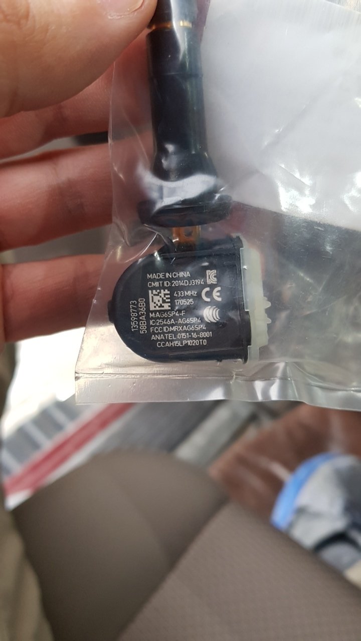

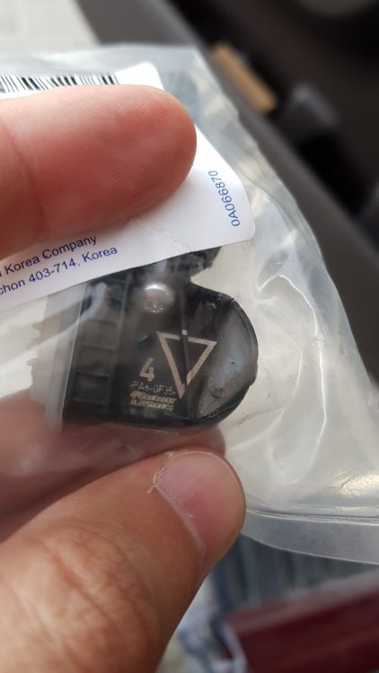

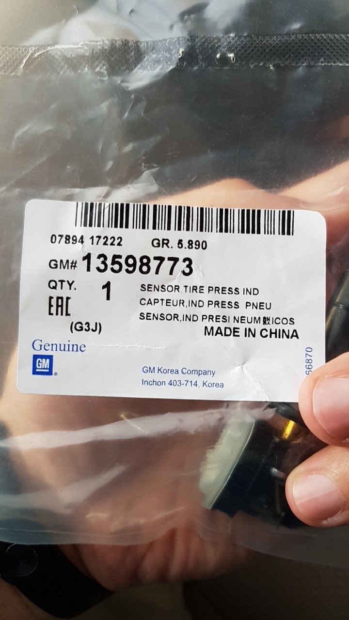

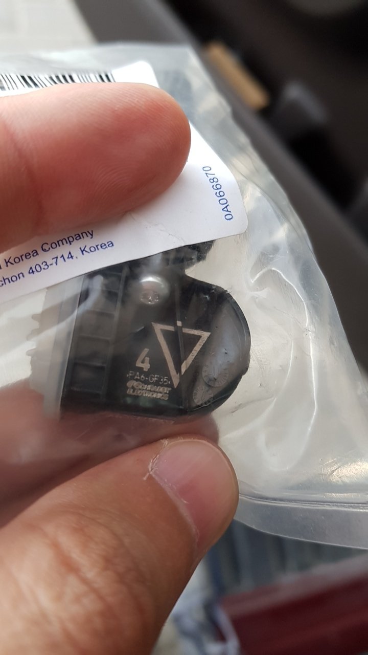

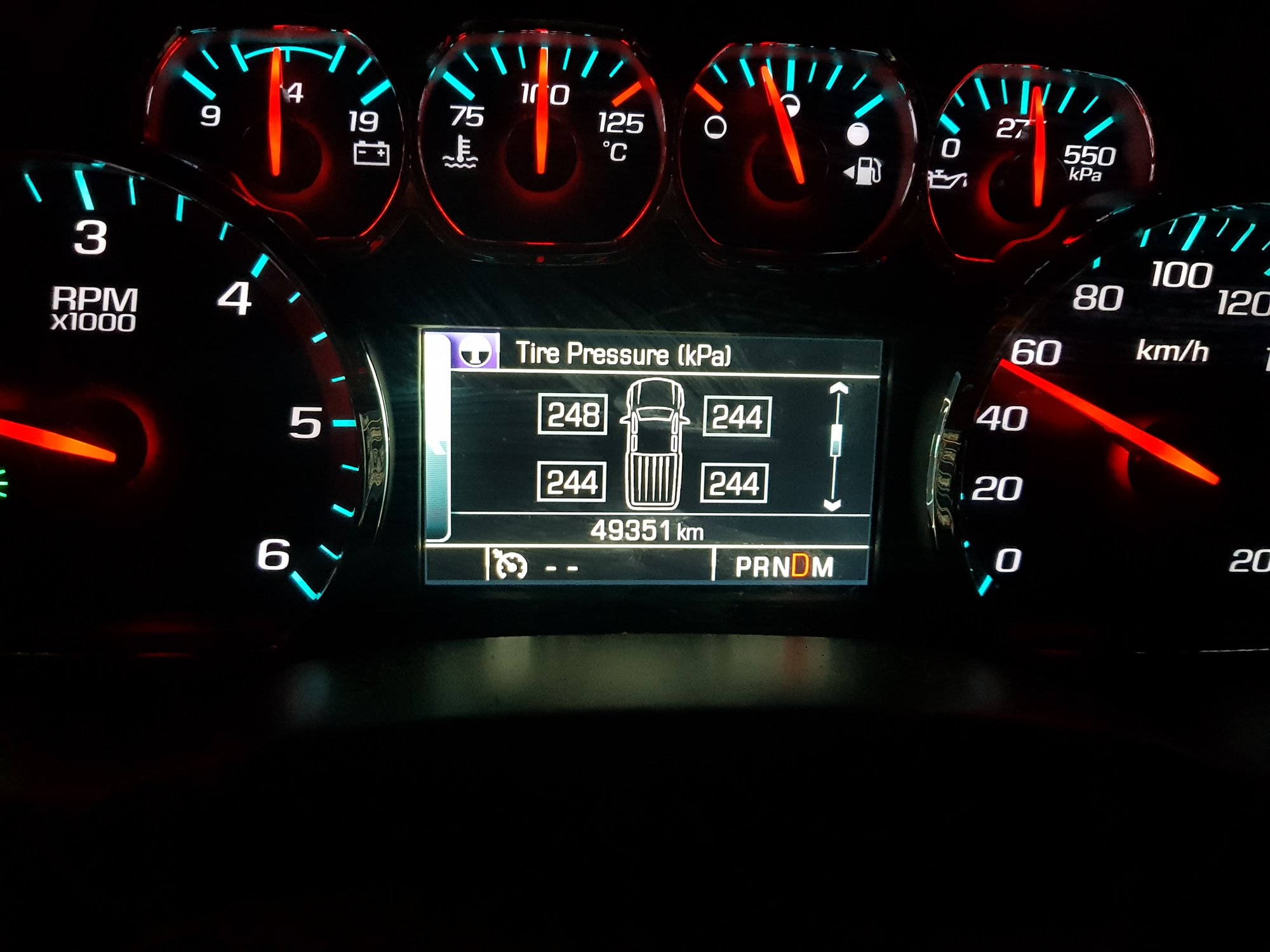

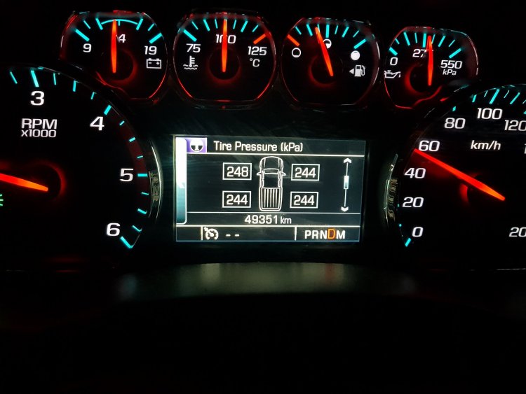

I bougt the sensors from the dealer and it costme 4 timea more :) but parently I got the right sensor for silverado 2015 lt.
Part number: 13598773
