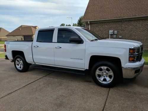

I have a half ton, but the parts you mention are the same with exception of the hood scoop.
I found painted handles on Craigslist and swapped them. Also found moulding on Craigslist. After removing the chrome, I liked the look without and ended up selling the white moulding.
There was a dealership selling the moulding on eBay (Bill Cramer, Panama City, FL). Not sure if they still do.
White seems to be the hardest color door handles to find. Not many swap them for chrome.

What color are yours?
