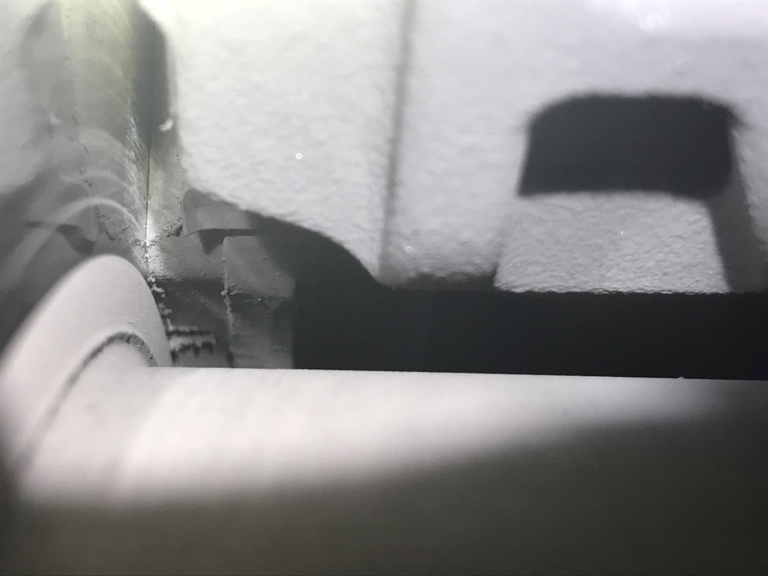

Obviously your brakes are fine. I do brake jobs for people all the time, and I charge $100 total. Most of the time, all it needs is pads. The pads cost me $10, and it takes 30 minutes to swap them out. If you go to the dealer, they will tell you the pads are getting fairly low, and that you need brakes. They replace the pads, resurface the rotors, replace the calipers, change the brake fluid, etc - and charge you $750 for something that you absolutely did not need. If you look at that picture, there is a "squeaker" in the picture. Its a thin metal tab that is attached to the backing plate. When the pad wears down far enough, that metal tab comes in contact with the rotor and causes a "sqeak" when you apply the brakes. Its put there intentionally as an indicator that the brakes are getting low. At that point, you have a few months left at most, before the brakes are metal to metal. No damage is done to the rotor until you are metal to metal (low grinding sound, and you can feel it in the peddle). So once you hear the squeak, buy some $10 pads and a Chilton repair manual. Or buy the pads and find a mechanic on Craigslist that will swap them out for $50. The next time you feel like going to the dealer, "STOP"!
