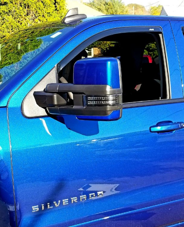

Has anyone painted the upper and lower caps on their tow mirrors to match the body color?
If you have an you please post some pics.
I think they look good with the caps paint matched87ed74138bb33a74193352085a2d9802.jpg

That looks really sharp. Never been a fan of the chrome mirrors; the black looked ok... I like the colour match for sure though.
Not my truck, a buddy of mine at a car show. Paint matched looks better than chrome!

That looks amazing. Thats how they should all come from the factory.
They were chrome caps. I sanded them with a med grit sanding block.
2 coats of adhesion promoter.
3 coats of primer.
Fine sand to clean up some imperfections in the primer.
4 coats of base
3 coats of clear
