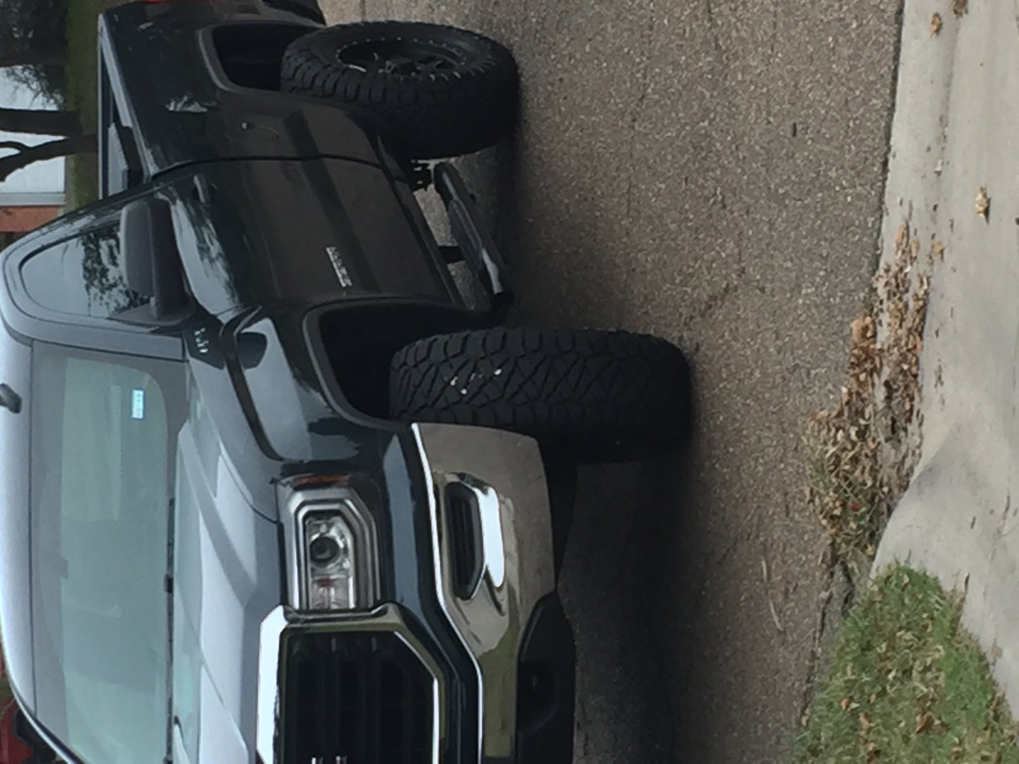

RC 2.5 inch level up front with 295/70R18 Nitto Ridge Grapplers on stock 18s. It only ever rubbed on the liner, until I trimmed it a bit.
I am running 35x11.5 Nitto ridge grapplers on 2.5" RC leveling kit. I trimmed the wheel liner and it doesn't scrub anymore except on full lock it does hit the sway bar.
IMG 4157

I do it for the looks. I love how dudes with 33s stare discreetly when I pull up next to them. Mine doesn’t rub on the streets and I have a set of 33s that I slap on once a month when we hit the trails. Works for me.
